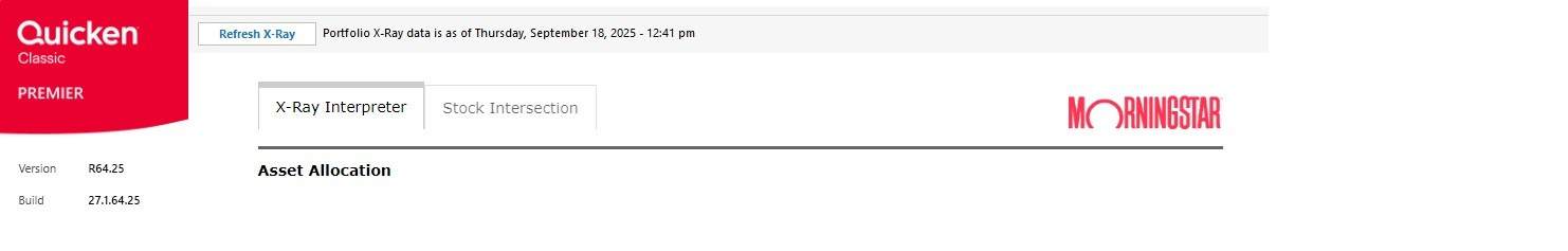

So now have to choose between these being fixed by updating to R64.xx and the loss of the Portfolio X-Ray feature that is needed by any serious investor. Really Quicken, you need to fix all of these!!! and GIVE US BACK PORTFOLIO X-RAY!
@Rick8 what version supposedly loses X-Ray? I'm running 64.25 (Windows) and I still see x-ray.
@AgBrewer97 You don't lose the X-Ray but the "improved" version in R64.25 shows less information than earlier versions and has other issues. See this discussion
QWin Premier subscription1 -
Sorry Jim, I meant lost functionality. Either way, it is not acceptable and should be fixed.

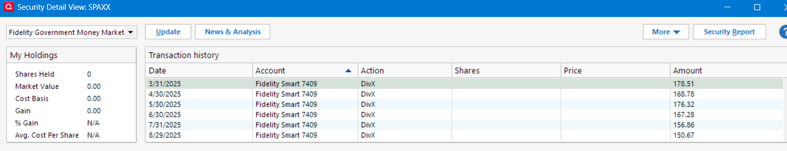

A few things I noticed and had to correct. Some of the DIV transactions for the core MMF had shares associated. I located these by accessing the fund in Securities, sorting by account, and looked for div or divx (if linked cash account) that still had shares associated. Just an aside, there should also not be and buy or sells. I open that DIV transaction (double click on the transaction) and clicked on Enter/Done and the shares disappeared. For one of my accounts, this was all that was needed to have it match the DC connection datafile shares and cash balances.
It wasn't as straightforward for the linked cash account. The cash balance was okay but the share balance was off and the core MMF still showed in the securities for the account. I sorted the investment register by Account and saw that Buy and Sell transactions were not removed for the core MMF. So I removed them and the share balance now matched, but the cash balance was off. There were many DEP transactions in the register for the core MMF after removing the buys and sells. Rather then invest the energy to figure out all the problem cash transactions, I made an adjustment transaction to the cash balance. Later, I went back and removed the adjustment transaction and located each out of balance transaction comparing to the datafile from the DC connection and corrected with adjustments to match the balance in the DC datafile. What made it messy is that I had changed from an FDIC sweep to a money market about a year ago and had kept the FDIC cash balance at $0.00 and allowed Fidelity to use the separte SPAXX security for cash payments. This was before SPAXX was allowed to be a core MMF. Quicken EWC+ conversion did not handle the sells and buys from the older FDIC transactions well. Which makes sense. The Cash Representation wants to know about the current core asset, not past ones.
