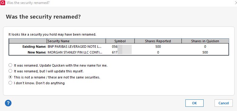

Quicken can't even stop trying to "fix" accounts that "look like" they are renamed, based solely on a share count.
How do we expect them to sort out this Fidelity mess (I'm affected as well)?
Below is one of several MLN accounts. Qucken frequently thinks I need to fix this. They don't even have close to similar names or CUSIP/symbol. Ridiculous that I pay a subscription for this garbage. Last week it changed 3 of 6 accounts at LPL to simple tracking, claiming they only supported Express Web Connect (they do not, they support Web Connect). I had to restore from a backup and reconnect those accounts after a few days of issues, they resolved.0 -
Thanks for the update. I have had that same issue with opening balances when restoring a backup.

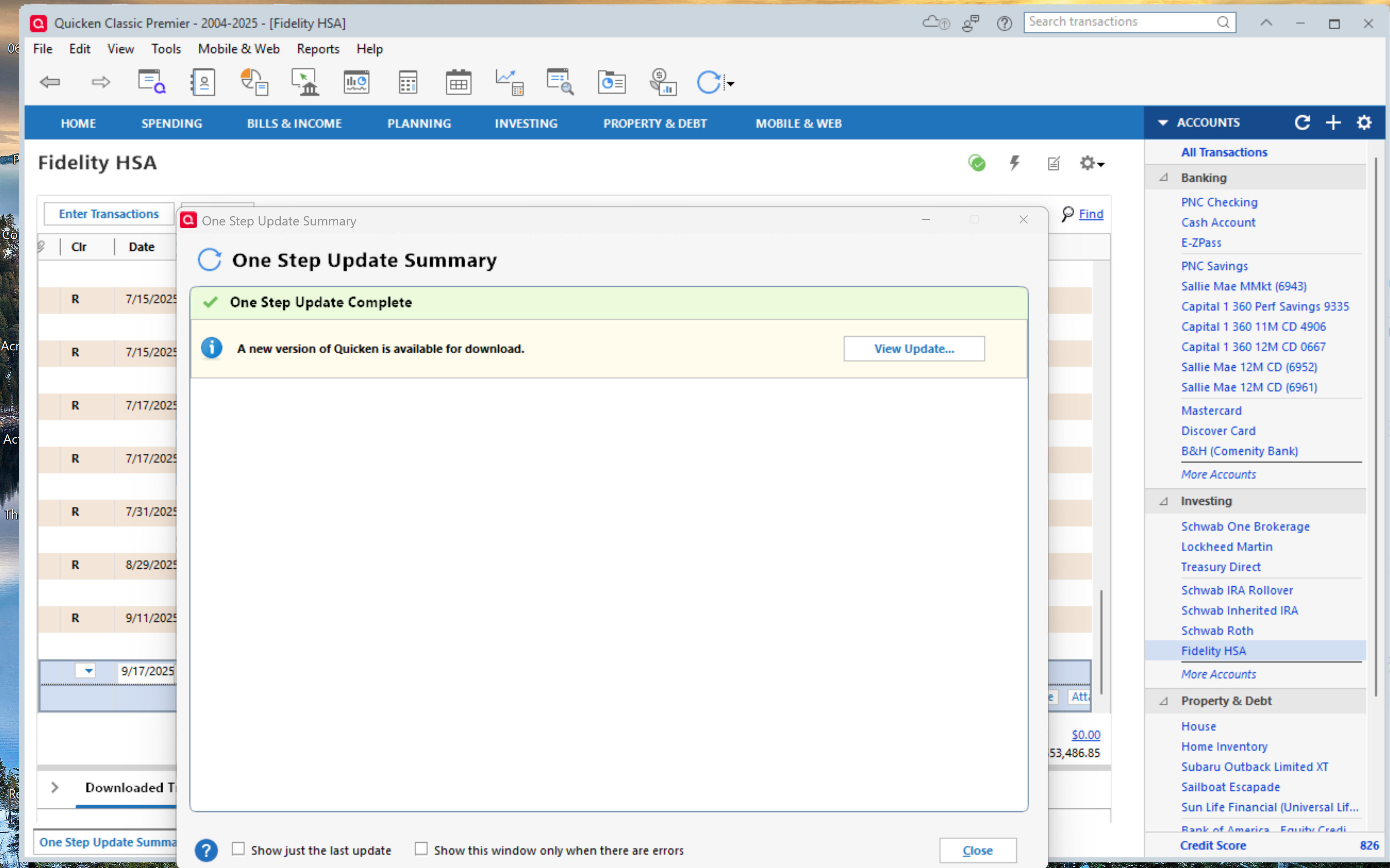

Fidelity is still not updating or reporting that they did in the OSU or the Account Page. This is exactly the same as the PNC update problem!!!
