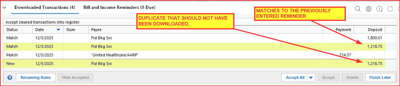

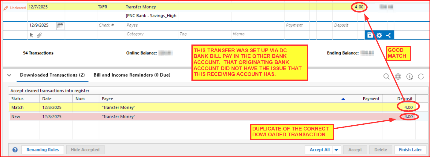

  • Boatnmaniac
    First, I want to confirm that so far I have only seen these duplicate transactions with my PNC Bank accounts.
    I think in order for us to be able to do as you requested, we need to first accept the duplicate transactions so we can then take a snapshot of them with the downloaded ID fields, right?
    If so, then I will need to wait for a future duplicate download incident before I can submit a Report about it because I deleted the duplicates before actually entering them into the account register.
    If not, I had already posted here and Reported one such incident on 12/6:
    The PNC checking account downloaded ID for the one that I accepted is 789. The duplicate transaction was deleted so I do not have any transaction information regarding that other that the picture I'd posted on 12/6 of it.
    I also had a duplicate transaction that downloaded today. I set up a DC Bank Bill Pay test transaction with PNC for a small $4 transfer between 2 PNC savings accounts. The duplicate appeared in the receiving account, not in the originating account. I did delete the duplicate transaction so I have no record of it in the account register. The receiving account transaction downloaded ID is 93. Following is a picture of what was downloaded this morning into the receiving account with the duplicate transaction.:
    If this information is sufficient, I will submit another Report. Otherwise I will need to wait until I get another duplicate transaction download. I look forward to seeing your reply.

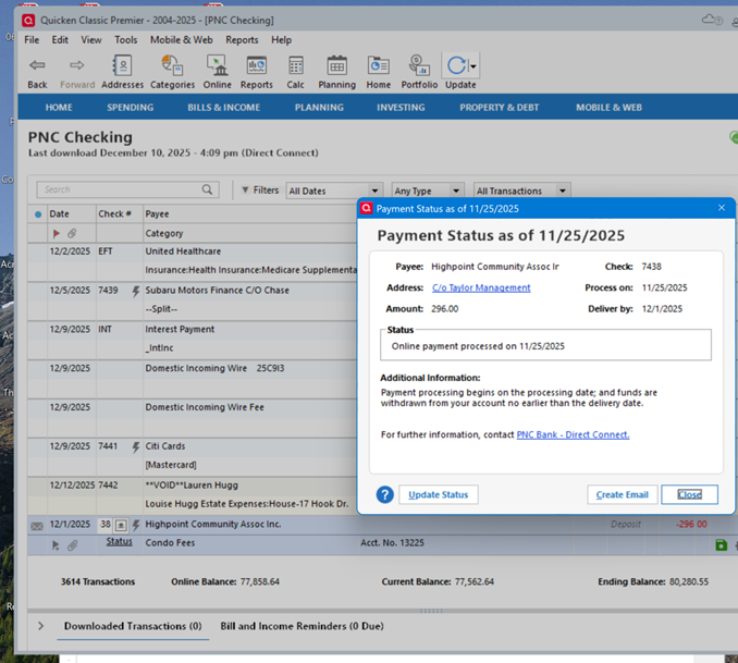

    PNC or/and Quicken is now not completing check transactions done through quicken. I issued a check to an account through quicken and PNC (Direct Connect) to be delivered 12/1/25. Today, 12/10/25, I clicked on the electronic "lightning" symbol in quicken and it said the check was issued 11/25/25. I checked with the receiving account and they did not receive the check. I called PNC Bank. They could not find the amount subtracted from my PNC checking account. They could not verify that the transaction was actually done on 11/25/25. I spoke with Tier 3 support at PNC and they could not verify the transaction. It cost me $5.00 to do a 1 time bank to bank transfer to correct this today. Tomorrow, I would have passed the grace period, and this would have cost me a $50.00 late fee!!!!!!!!! Is quicken going to pay for these when we assume everything is working as it should, without checking every damn transaction, or duplicate, triplicate, transaction!!!!!!?????????
    I am posting a screenshot showing the confirmation that it was processed on 11/25/25 as this cannot be uploaded via online "there is a problem" . Would be useful of this was possible. This is the report today.

  • Boatnmaniac
    From the picture you posted it seems that this payment was sent via mailed check, not via ACH. Mailed checks are the least reliable method of payment.
    Don't you think it's possible that the mailed check might not yet have been delivered or might have been delivered to the wrong address or might have been lost in the mail (all are USPS issues, not PNC issues)?
    Also, I have experienced once in a great while where a mailed check (either one I hand wrote out or that the bank printed and mailed) was actually delivered on time to the payee but they misplaced it or simply did not process it.
    BTW, PNC does not debit the checking account for any of their bill pays (either ACH or mailed paper checks) until the payment has posted. So if the payee's bank has not processed the check then PNC would have no visibility into the status of the check beyond what their system says when they processed the payment.
    In addition, the folks inside PNC (including their Tier 3) does not have visibility to bill pays made via Quicken….just like you will never see Quicken bill pays in your online account at PNC until the payment has actually posted and even then it will never show up as a bill pay transaction. (This has always been a concern of mine but in years of doing Quicken bill pays with PNC they have never missed processing a payment of mine on-time.
    What makes you think that PNC has stopped transactions downloading? Posted transactions will generally download 1-2 business days after posting. But I must admit I did have one payment that posted on 12/5 but it did not download until today…5 days but only 3 business days so only 1-2 days past when I'd anticipated it would download.
