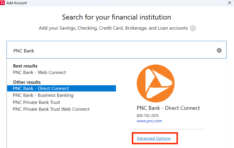

In a test file I just deactivated my DC connected accounts and then did Add Account > PNC Bank - Direct Connect > Advanced Options > Direct Connect > entered my DC login information > Linked the downloaded data to the accounts already in Quicken. Here was the results.:
- The set up process completed properly.
- 9 new/missing transactions were properly downloaded.
- 8 duplicate transactions were downloaded into the checking account. 6 were dupes of the new/missing transactions that were also downloaded. 2 were dupes of late Sep transactions (which I deleted).
- 2 duplicate transactions were downloaded into the HYS savings account (which I deleted).
- 1 duplicate transaction was downloaded into the std savings account (which I deleted0.
- The Online Balances were finally showing up below the registers of all 3 accounts and they were correct!
- Reconciling to the Online Balance functioned properly.
I then rushed to open my primary data file, deactivated my DC connected accounts there and then did Set Up Now. No joy.
- DC setup completed and the data was Linked to the accounts already in Quicken.

To get back on Direct Connect, backup your file and deactivate the accounts. Navigate to Tools>Add Account, search for the PNC connection you use, and make sure to click Advanced Options.
Make sure Direct Connect is selected, click Next, and follow the prompts.

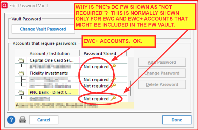

After reading your post I checked the PW Vault in my primary data file (the file which is not working well with PNC's DC) and found an oddity: "Not required" is shown for PNC Bank - Direct Connect. That should not be. It should show "Yes".
I was not able to change nor delete the PW for PNC Bank - Direct Connect. So I took the following actions:
- RESET VAULT: This did not work and nothing was changed in it.
- DELETE VAULT AND ALL SAVED PWs: The Vault was deleted. But when I then set up a new Vault it automatically populated the entire Vault with the exact same data as shown in the above picture. That should not happen.
I then opened my test file (in which PNC's DC is working correctly) and noticed this PW Vault oddity does not exist there and PNC Bank - Direct Connect shows "Yes" for the PW, as it should.
This leads me to believe there is either a corruption in my primary data file or there is an issue with the Cloud Account for that file.
(I did not run Validate to fix this because Validate always deletes a lot of data for an old (closed) investment account so I avoid doing that. Others might want to first try doing this before proceeding.)

When I set up PNC Bank - Direct Connect via Advanced Options and selected Direct Connect I got the following results:
- All PNC accounts are now connected with DC.

- If that doesn't work, check your PW Vault to see if it might be showing this "Not required" oddity for PNC.
- If it does, you might want to try doing Validate & Repair to see if that fixes the PW Vault issue.

Thank you! I found the “password not required” issue too. I guess I don’t understand what the password PIN does. If the vault is corrupt and there is no password …. why do we still get the green globe and the successful connection popup? I guess that is not where the DC PIN/PASSWORD is used in the process?? I haven’t disconnected-reconnected for two weeks. Did you also disconnect-reconnect recently too?
I assume you can simply recreate the vault when ready… right?
thanks again.0 -
The "not required" in the PW column is supposed to only apply to EWC and EWC+ connected FIs because the EWC login info and the EWC+ security token are saved on Quicken hosted servers (Intuit?), not on the hard drive. I don't understand why they are now showing up in the Vault because it is my understanding that there is nothing about EWC and EWC+ that needs Vault in order to function (unless something about that has changed).
But DC connected FIs in Vault should have "Yes" in the PW Stored column because the PW/PIN is saved in the Vault to protect it from being compromised. I've never seen "not required" there before. That's what prompted me to think that either there is some sort of corruption at play.

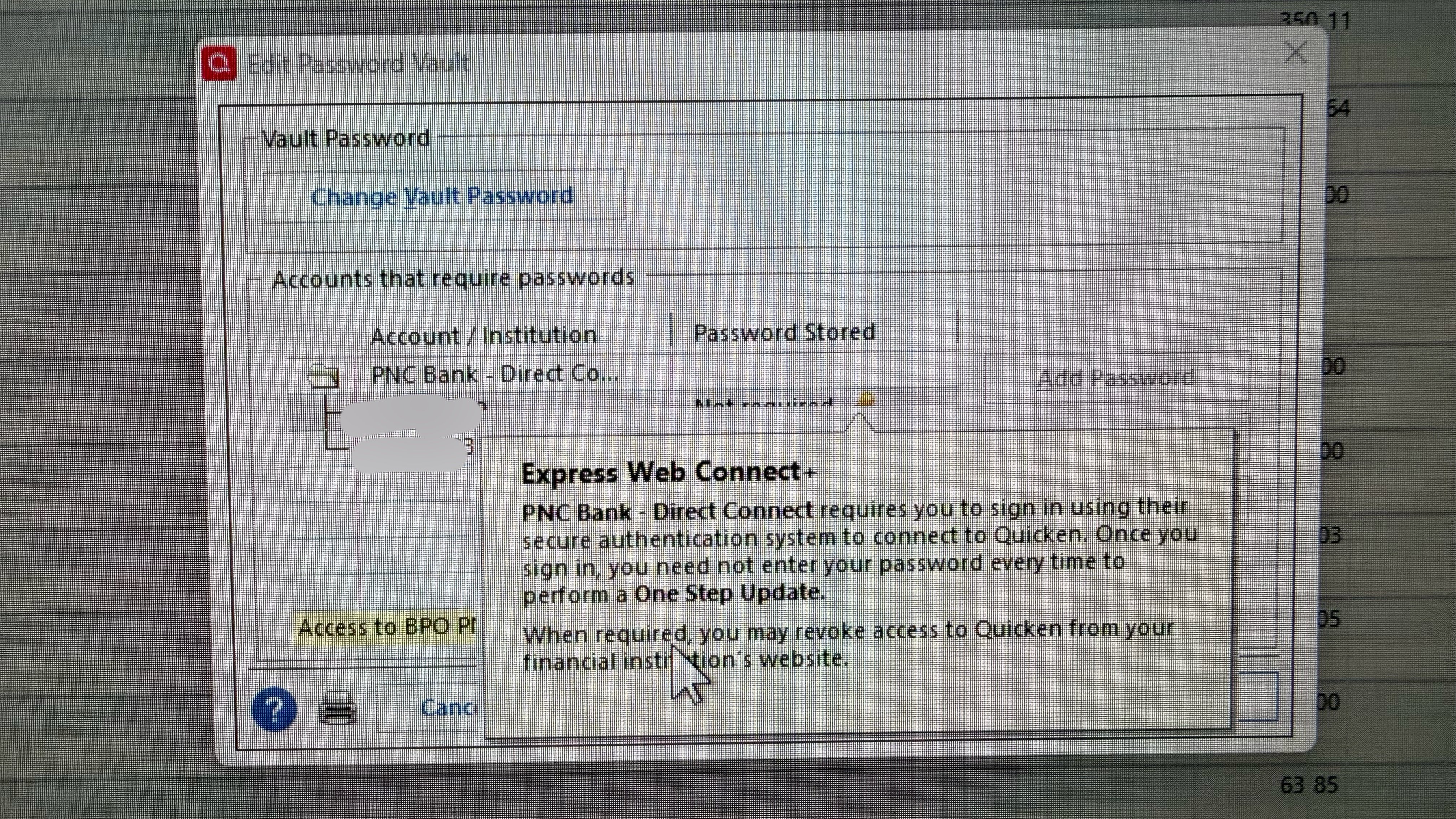

Thank you for the explanation. The last time I Diconnected-Reconnected I did end up with two EWC+ loan accounts and 8 DC accounts. I have no idea how I did that. I get this when I click on the tiny “key” icons in my vault. I plan on deleting the loan accounts out of Quicken completely … as I never had them in Quicken before 10/24 anyway.
I am gonna wait until Monday and disconnect and reconnect. At that point if it’s still not working (and I’m pretty sure that will be the case), I plan on calling Quicken support and showing them the vault with “not required”. I’ll let them step me through the process of fixing the vault, etc.thanks again.
Thanks for that picture. Yes, that is the "corruption" that I talked about. It shows that your account is set up with with the DC FI but the PW Saved column also shows that it is, instead, set up with EWC+ and not with DC. So I'm assuming this is causing a conflict during OSU that is allowing some data to download but not all data to download. Since there is a good download there is nothing to flag an error because of the missing or incorrect data.
I'm speculating that this issue might have been caused by another issue that I identified a couple of weeks ago during the Add Account process for PNC Bank - Direct Connect when not clicking on Advanced Options. When you click on Advanced Options you will see that it opens a popup showing Express Web Connect and Direct Connect with EWC being the default. First, I don't think EWC should even be listed there. But most important is that DC should be the default, not EWC. I think that when DC is not selected as the connection option it tries to set up an EWC+ connection with an Add Account Direct Connect FI listing that does not really support EWC+.

So, that's why I began posting that during the Add Account process we need to manually change the default to the DC option. I see the Moderators have recently begun to post the same thing.

I screen shot the Vault on the old computer so I can show it to Quicken support ….. I promise not to open the old Quicken again until the is all fixed :-)
