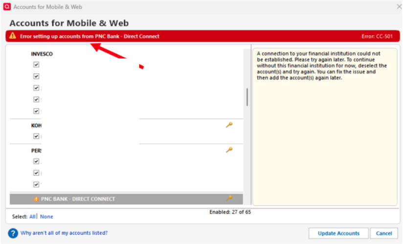

    December 18 Update for PNC Direct Connect
    After two weeks I have received my new PIN and tried to attempt to reconnect my 8 PNC checking/saving accounts. Unfortunately I got the exact same results as 2 weeks ago while trying to re-activate. At the very end of the process it throws an error "We encountered an error while connecting to your bank". The accounts appear to be set up with DC and BillPay in the account list, but I can't send payments or download because I get an OL-293-A error. Just like two weeks ago. I disconnected all accounts.
    I spent a total of 2.5 hours on the phone with Quicken. We tried a file copy and a blank profile when attempting to add DC and BillPay and got the same error before completion…. and OL-293-A when trying to connect. Unfortunately Quicken support pointed in the direction of PNC for a fix. They had no suggestions.
    After I hung up, I wondered if the errors were caused by a single account or all my accounts (I have no idea why I didn't think of this earlier). I went in to "add account", and one at a time I added my accounts. BINGO! I was able to add every account without an issue EXCEPT for my main checking account (where most of my activity is). With 7 of my 8 accounts connected, OSU works every time and I was able to bill pay from another checking account (which really doesn't help). Nothing missed and no duplicates in the 7 accounts. I simply can not add this 8th account either "linked" or as a new account without getting the set up error and the OL-293-A update error.
    The DC and BillPay problem is just with a single checking account. @Boatnmaniac can you think of a reason for the issue with a single account? Any ideas of what the fix might be? This is the account where 95% of all my activity is….. many BillPays. I contacted PNC Tier 3 again and they opened a ticket and escalated it to the "resolution team" and had me email them the OFX log. Fingers crossed…..
    Any advice from the forum is appreciated.
    Charlie

    @charlieo.Hemlock
    I received my PIN yesterday and my experience was very similar to yours. I attempted to reactivate my accounts (I've got two) while on the line with PNC Tier 3 and got the same "We encountered an error while connecting to your bank" message at the end. My accounts also appeared to be set up afterwards, but any attempt to update resulted in the OL-293-A error. The PNC rep had me send my connlog file, told me she would escalate it to the resolution team, and that I should expect a call back in a few days.
    That said, there is one thing that should have occurred during the attempted setup but did not: PNC requires you change to change your password as the PNC-supplied PIN is for setup only. The PNC rep I was on the phone with expected me to see a prompt to do so, which I also recall seeing in the past, but it never happened. I tried several more deactivate/reactivate cycles, including one with a Quicken copy of my data file, but got the same results — no request for a password change and the same errors as above.
    Did you ever get the prompt to change your password? I'm wondering if that missed step in the process is why it did not complete for me. And I would guess it is the DC service provider, Intuit, whose software produces that prompt, not Quicken. Perhaps @Boatnmaniac will have some insight about this anomaly as well.
    It's interesting that you got all of your accounts but one working. I've a checking and a savings account, so will try adding one at a time and see if one or the other works.
    Hoping to hear back from PNC soon to see what they say, and am sure you are as well!
    Greg

  • charlieo.Hemlock
    charlieo.Hemlock Quicken Windows Subscription Member ✭✭✭
    I did get the prompt to change the PIN and I did. I have been using the new (user created PIN) since. BTW, If you delete the user created PIN in Quicken, you will still need the original PIN mailed from PNC.
    3 savings accounts and 4 checking accounts. Some have BillPay active, and it works too on the activated accounts.
    There are three players involved with Direct Connect. On the user end there is Quicken, in the middle is Direct Connect (the company that does the OFX mapping and is owned by Intuit) and then there is PNC (the bank). I suspect the authentication (PIN) is a passthrough …. from Quicken to PNC for security reasons, but I am only guessing.
    The one account that will not activate for me is a checking account where I have many downloads and many BillPays. When it does the BillPay part of the activation it takes a couple minutes to complete. I wonder if this account just has too much "stuff" going on or has triggered some artificial limit. It worked great for two weeks after PNC fixed DC.
    Although it does me little good, OSU on my 7 accounts has been working well. I will stay in touch and let you know if anything gets resolved. Please do the same. Good luck!
