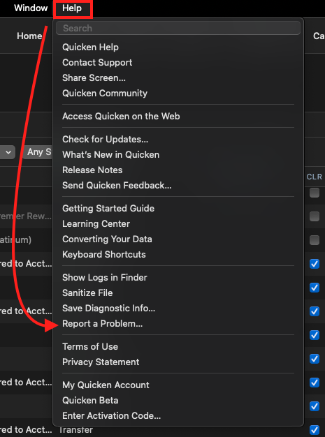

  • Quicken Alyssa
    Thank you for continuing to update the discussion with your progress.
    It seems that for most, this issue is resolved. Is anyone still experiencing transactions downloading into the wrong accounts with Elevations?
    If so, please send over new log files so I can update the escalation ticket.
    To do this, go to Help>Report a problem>Send to Quicken from within your software. Let me know once it's done so I can collect them.
    Windows:
    Mac:

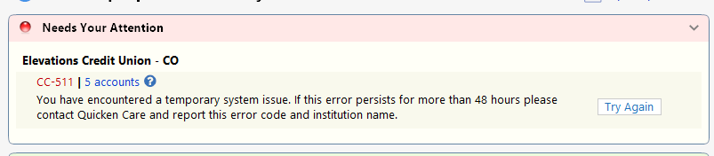

  • DerekT
    DerekT Quicken Windows Subscription Member ✭✭
    I thought that I was good to go, but just tried to sync this afternoon (1/11) and I get this now:

  • Quicken Alyssa
    Thank you for adding to the discussion.
    If anyone is still experiencing transactions downloading into the wrong accounts, please let us know and submit logs, as outlined in my previous post.
    @DerekT,
    After reviewing your connections internally, it looks like the error you were receiving has resolved. Is that correct?
