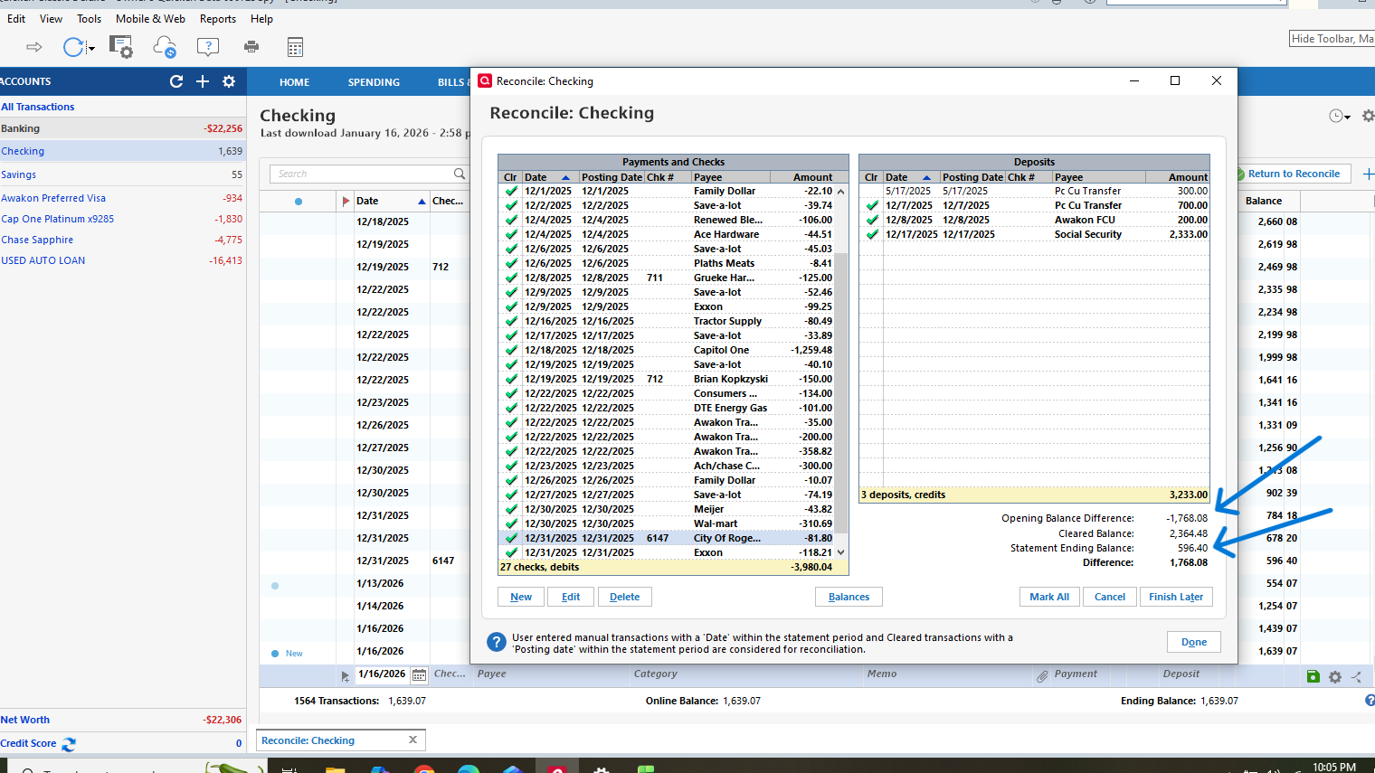

    My starting balance is incorrect. I can change the opening balance amount, but quicken then decides to account for it as a difference. All my transactions balance, and have no idea why it's doing this! Please help!

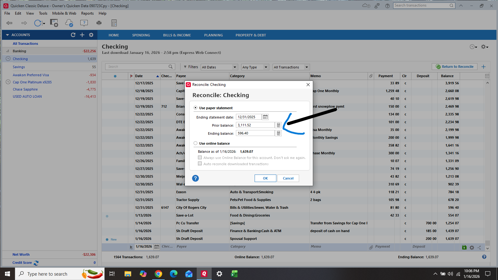

    Thanks so much for your reply Quicken Kristina. In the reconcile window, the beginning balance (last months ending) is totally incorrect. It will allow me to enter the correct prior balance, but then throws off the total reconciliation.

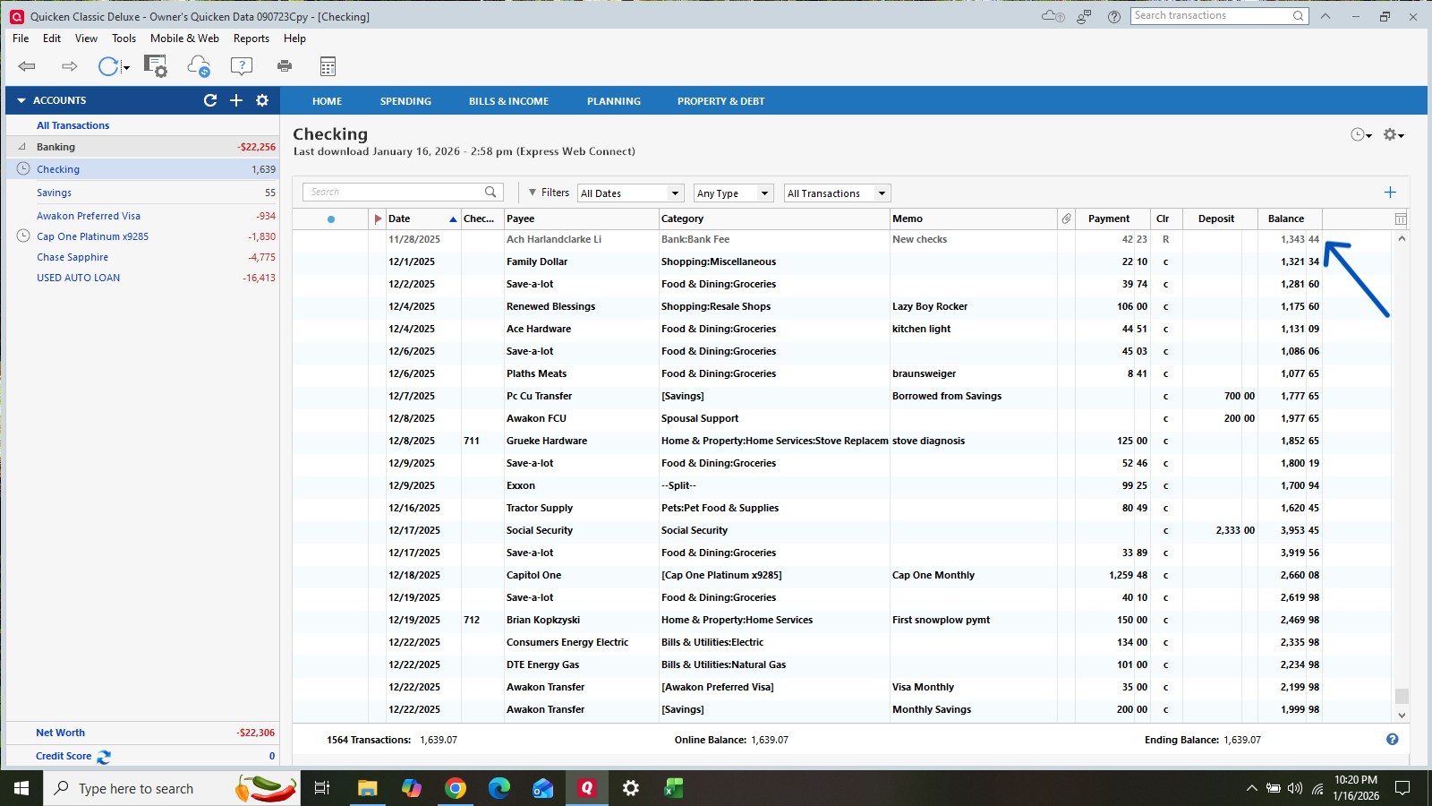

    One possibility for the previously reconciled balance being off is that Quicken has changed the account's Opening Balance, usually the very first transaction in the register. Annoyingly, this sometimes happens when you reconnect an account for downloading.
    If you don't know what the opening balance should be, you can open a backup from before the problem started, write down the account's opening balance, then return to your working file and update the Opening Balance transaction.
    To make it easier to recover from this problem, I record each account's correct opening balance in the Memo field of the Opening Balance transaction. This makes it easy to check and if necessary correct the transaction.

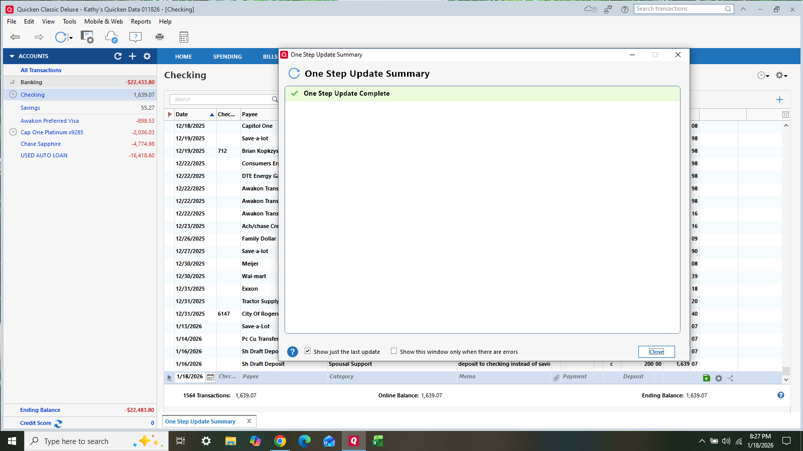

    I'm back in Quicken @Jim_Harman. Now it won't allow me to do a one-step update. It has a box to enter passwords, but won't allow me to add accounts or put in passwords for them. I changed my vault password as it prompted. If I just ignore, the second pic is what it shows. It doesn't update anything, and my accounts are unaffected.

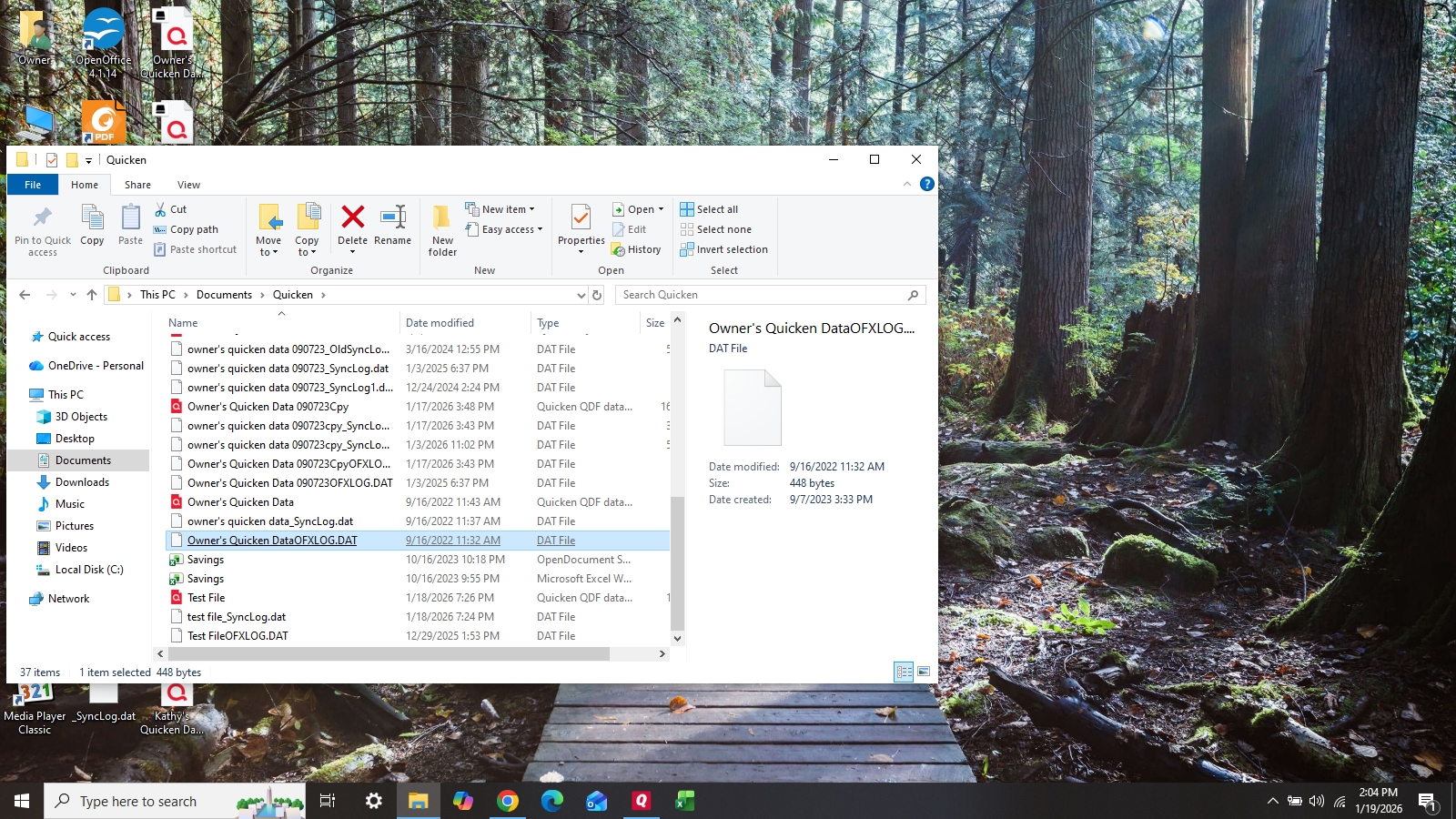

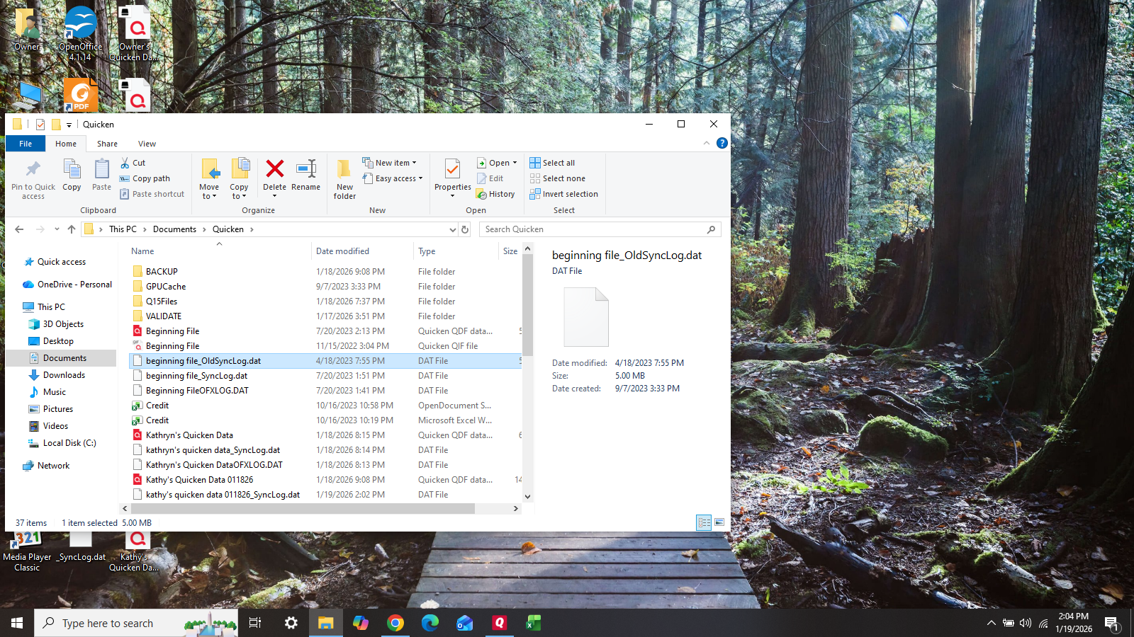

    As for what file I had used, I really don't know how to tell the difference. What is the difference between the files with the red Quicken icon and the others? I probably chose a DAT file. Whatever it was, it was data from 2015, so not useful.
