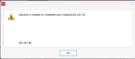

For years, I have downloaded by transactions at the USB website. The transactions then populate into my several accounts in Quicken. (I don't use instant download for these accounts through Quicken because of repeated problems doing it that way - other accounts I do).
So, now I am getting Error message OL-221-A and OL-221B. USB put me on hold and transferred me to Quicken. Quicken says it's an error on behalf of USB.
Anyone have this problem? A solution?

When I try to download from my US Bank account I get an error unable to complete request OL-221-A

I am having the same problem with my USBank account; when I try to download QFX I get
"Quicken is unable to complete your request", OL-221-A,.

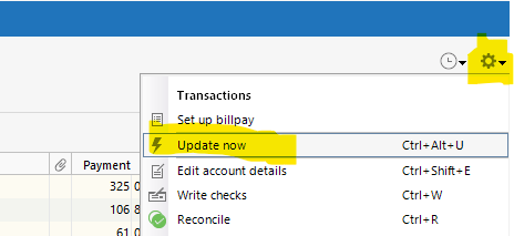

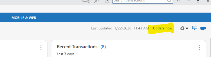

There is also and UPDATE NOW in the top right corner (see below snapshot) when you are not in a specific ledger. This Update Now activates the OSU feature for all EWC+ accounts.
Use TOOLS → Account List (CTRL+A) to see what "Transaction Download" method each of your accounts are setup for … a " Yes (Improve Connection) means you use the manual QFX download; a "Yes (Express Web Connect +) means you use a more automated download, where you entered all your Account Details and chose to use "online services" to update when you setup or edited the account vs the manual download.
