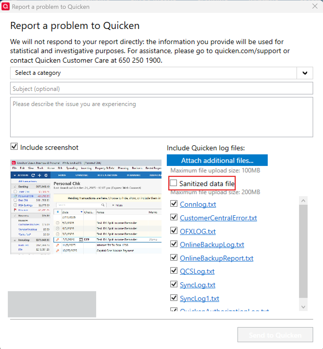

    When you do Report a Problem and select the option to provide a Sanitized file, Quicken will automatically create the Sanitized file so there is nothing you need to do in that regard.
    Optionally, you can manually go to Help > Contact Support > Sanitize Data File Copy. Then you can attach the copied file to your reporting of the problem. But that's just more work for you.

    @petermartin1950 as @Boatnmaniac mentioned, Quicken will automatically create the sanitized file when you submit it through Help > Report a problem.
    To add a bit more detail, in the Report a problem window, you’ll see a checkbox option to include a sanitized data file. Just make sure that box is selected before submitting.

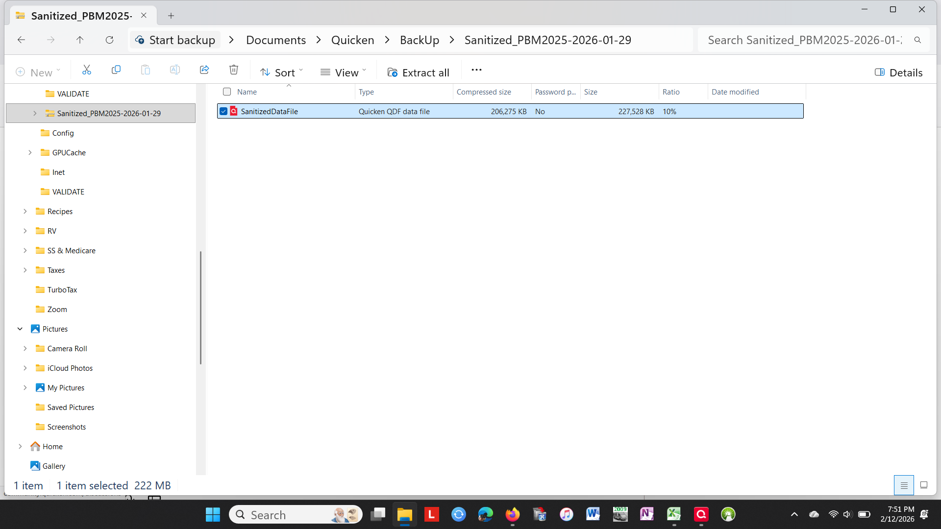

    Painfully discovered with Marco at Quicken Support that my Sanitized Data file is too large to upload.
    What do we do next? I believe these program issues need to be resolved. Otherwise this program does not work as intended and rendered useless for Planning purposes.
  • Jim_Harman
    @petermartin1950 if a sanitized version of your working data file is too large to upload, about all you can do to help Quicken diagnose this problem is to see if you can tell what reliably triggers it.

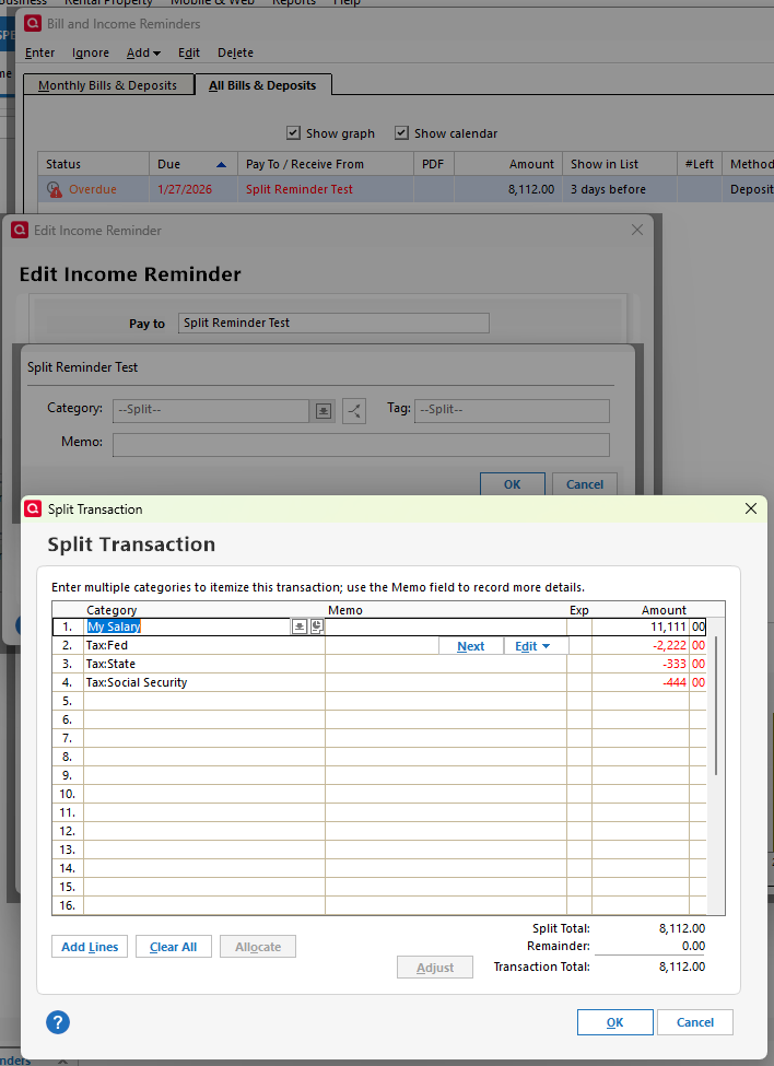

    I set up a test file with one account, a split reminder for salary and withholding, and syncing enabled. This is a plain split Reminder, not created by the Paycheck Wizard. The split lines in the Reminder look like this
    I made a template copy of the file and on the copy, did a Sync now on the Mobile and Web tab.
    I checked the Reminder and the Tax Planner and nothing has changed.
    Is there something else I need to do to trigger the scrambling - access the data via Quicken on the Web or something? I will continue to experiment.
    [adding] I enabled Sync to cloud on closing, exited and restarted Quicken, and did a Sync now.
    Now the order of the split lines in the Reminder has changed, but the amount for each split is still correct. The Tax Planner results have not changed. The reordered split lines look like this:
    So I am able to replicate the reordering of the split lines after a Sync, but because the amount for each line is the same, the Tax Planner results are not affected.
