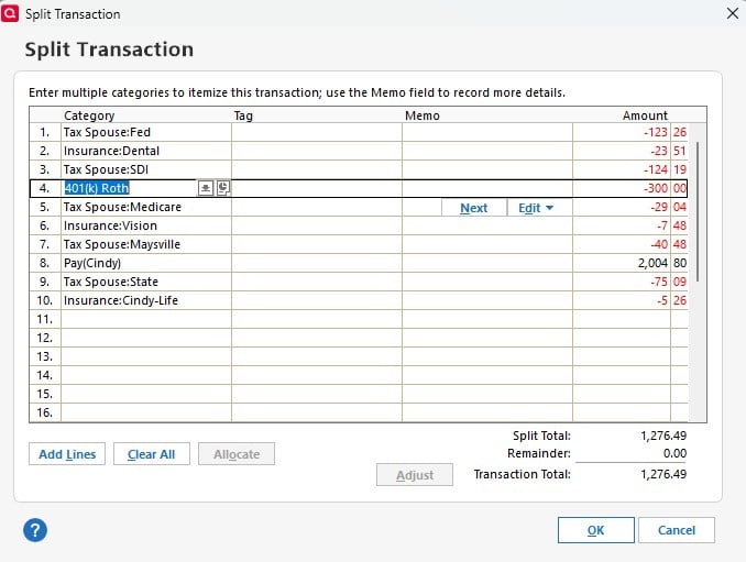

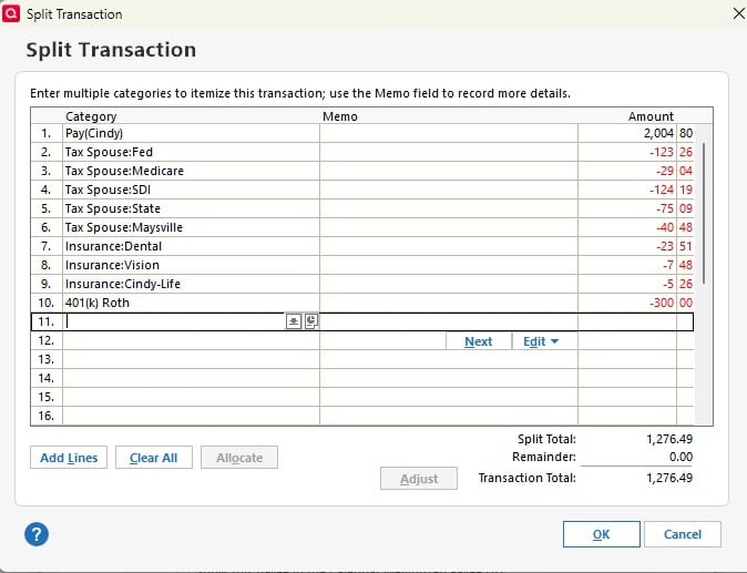

I manually entered in split categories to reflect a paycheck. The order of the split items needs to remain the same.
However, when I call up the memorized transaction two weeks later, it looks like this:
