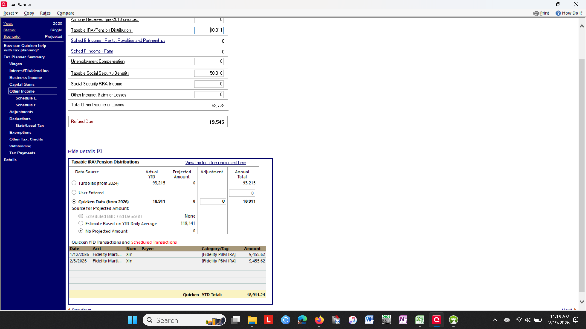

Today's screen for TP. No split scheduled transactions involved. This is just plain gobbledigook.
Scheduled (Transfer) transaction (non-Split) are not being picked up for Taxable IRA/Pension Distribution.
I have deleted the Transfer for IRA distribution to another Investment account. That made things worse. The scheduled transactions still don't show in Scheduled Transactions in TP. The Taxable /Pension Distribution is even more messed up. Have no idea where this $276,104 figure comes from.

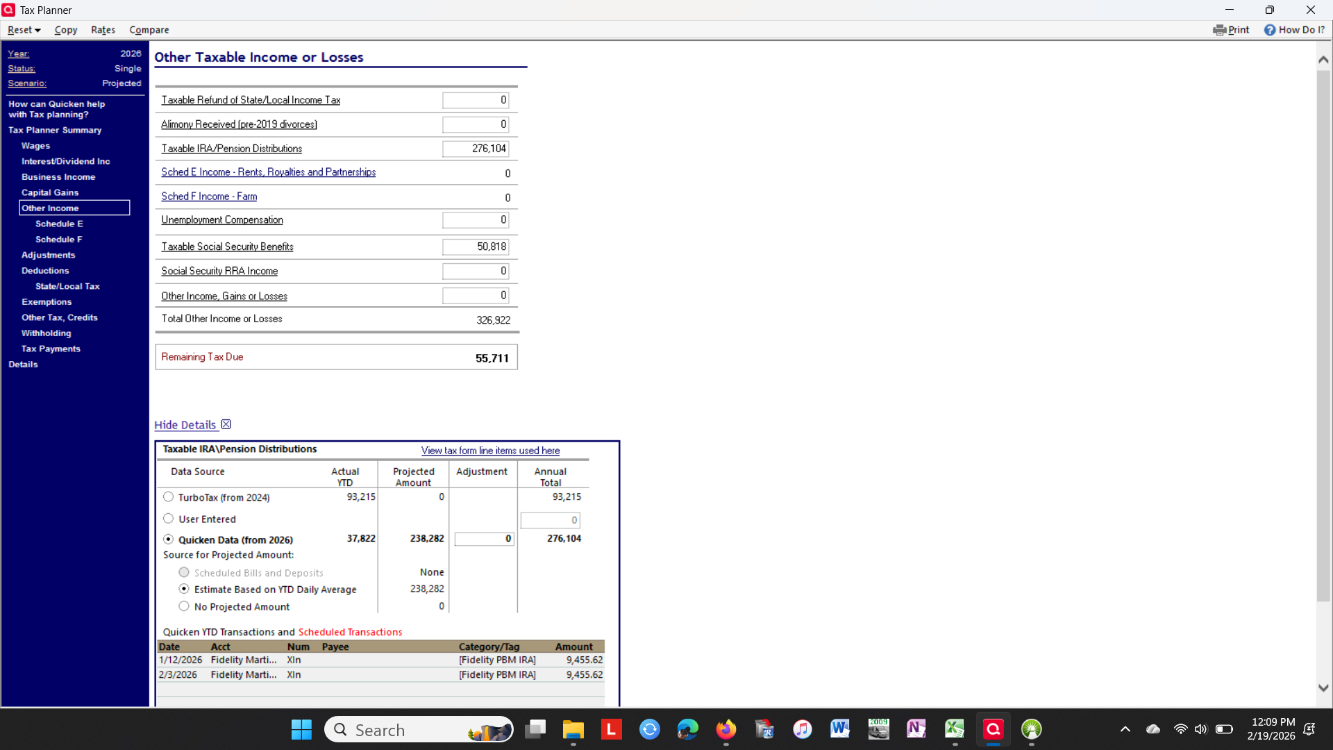

Removed the Estimate based on Daily Average. This screen shot shows up. Again no clue where this program is pulling these figures from. This $37,822s 4 months or entries. Notice the source from "Scheduled Transactions" is absent from the screen.
