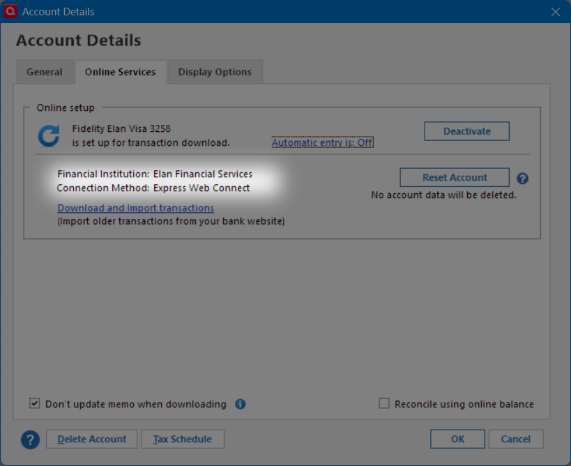

I'm having a related problem since this botched interface change was implemented. My recent Fidelity/ELAN credit card transactions are visible on the Fidelity and ELAN websites but do not download. Quicken one step process reports a successful connection but no new transactions to download. Having to download the transactions as a csv or qfx file and upload them into Quicken, while it works, is too cumbersome and is not the level of service we've had in the past. Has this been flagged for investigation and fix? If so, please lead me to the right discussion.
I'm having success downloading the Fidelity Visa credit card transactions from the Elan FI using EWC instead of from Fidelity FI.
I still successfully use DC for Fidelity downloads.

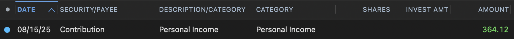

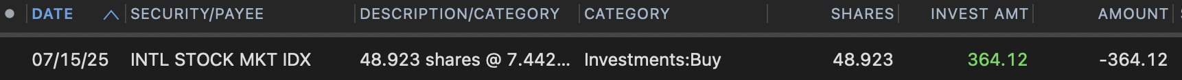

BUT, that's some of my accounts. My 401k transactions are downloading as generic contributions rather than as specific security transactions. Previously, 401k transactions downloaded with security names, descriptions/categories, category as Investments:Buy, share quantities, and investment amounts.
Now, however, ALL transactions download with the security name of "Contribution", descriptions/categories are all "Personal Income", category is always "Personal Income," the dollar amounts are there, but all of the share quantities and investment amounts are blank.
I have 9 securities in my 401k portfolio, so figuring out which security belongs to which transaction will be a time-consuming challenge.
Also, I guess because these are coming in as contributions rather than buys, the there are no offsetting ledger values. This causes the balance to grow incorrectly.

Not a solution to the problem, unfortunately. But, I have been going to Fidelity website and viewing recent activity for recent pay period.
9 Funds here myself: I delete those erroneous cash "contribution" transactions and type in the buys. Takes 10 minutes to enter, but gets the share & cash correct and removes the placeholders and correct market value.
Thanks, @John_in_NC I was just about to do the same thing. 9 funds here too.

Before starting that, I reconnected my Fidelity 401K and ran the auto-update. And, it worked!
Meaning, it downloaded normal transaction records complete with security names, quantities, and investment amounts. It meant that I ended up with pairs of transactions for the same dates, but it was no big deal, quick & easy, to pair up the amounts and delete the placeholder "contribution" records.
The only hitch was a new one. It appended " 2" to the security names of all the new good records. Again, no big deal to fix them. Hoping eventually that issue goes away soon.
