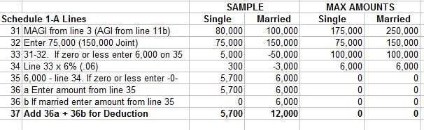

If anyone is interested I made a spreadsheet to calculate the Senior Deduction. It may be a little complicated for Q to add it in fast. The income limit is 75,000 (150,000 Joint), it is reduced by 6 cents for every dollar of income over.
