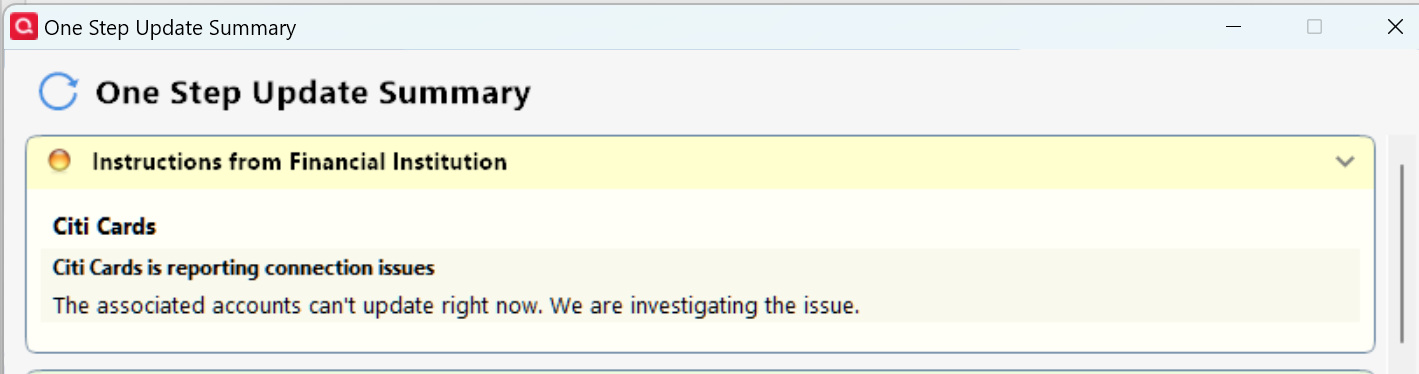

Citi Cards reporting connection issues
Been receiving this for several days…
Quicken Classic - R66.18, Windows 11 PRO current on updates
My data file is NOT being synced nor backed up.

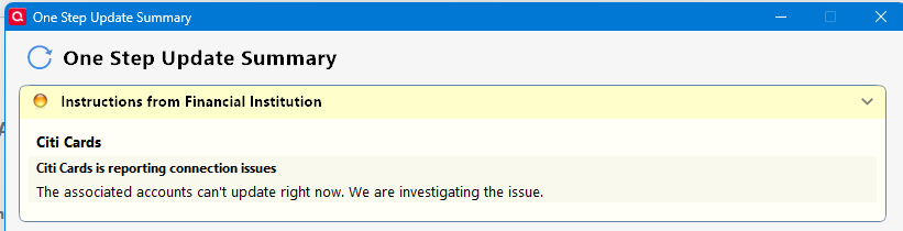

For the past week I have been receiving the message:
Is this a CITI Card issue or do I need to do something to restore the connection?

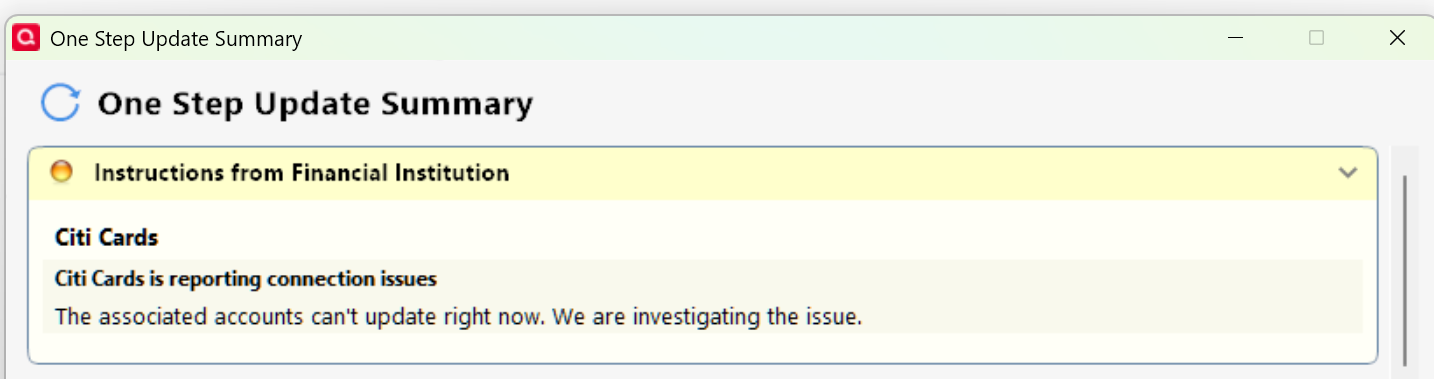

This started yesterday. No error number that I can find. See attached.

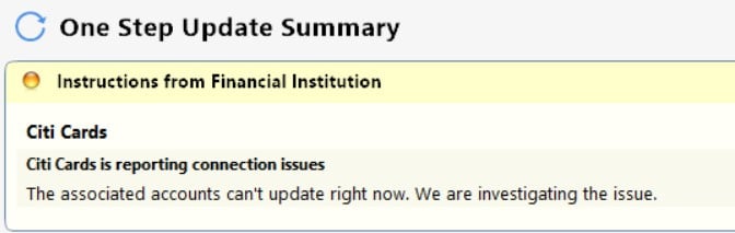

Following the instructions to rename the runtime.dat file had no effect. Error persists.
It seems that my Citi transactions are downloading, but I am experiencing the same issue as others above so I would be interested to see any solutions. Just wanted to add my name to a list of users experiencing this problem.

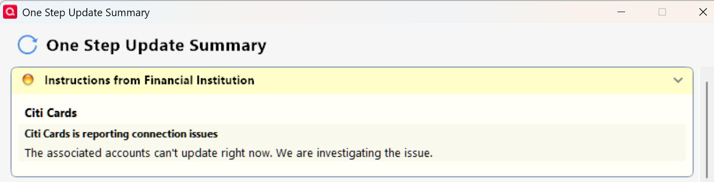

Same here. Connection failure began about 4 or 5 days ago. After update I get the message
"Citibank is reporting connection issues. The associated accounts can't update right now. We are investigating the issue."

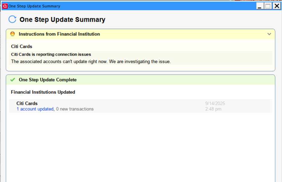

Same for me. I get transactions when they exist, and I still get the error messages. It causes extra work on my part because one of the reasons I download regularly it to make sure there isn't any extra transactions. So, If I get an error message I end up logging on to Citibank manually. It's been going on for a while now.
Same for me. Have renamed the .dat file on several occasions; solution works for a few days, then problem returns. This has been going on for weeks and weeks now; how hard can it be to get it fixed?

It's October and the displayed error continues to appear. As reported elsewhere, the Citi card accounts are being updated, but I have to manually check to make sure.
