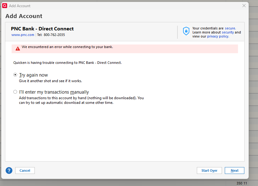

My connection is still broken. I deactivated and tried to reactivate all accounts with DC. It gets 90% done and then gives this error. Any thoughts? Quicken support says its a PNC problem. Accounts show as activated in the account list with Bill Pay … but still doesnt work. Password is in the vault.

I was still getting the OLA-293-A error this morning so decided to try deactivating/reactivating my accounts before calling PNC. But unfortunately, the reactivation would not fully complete — I encountered the exact same error for PNC Bank - Direct Connect that you posted above (Dec 3), stating "We encountered an error while connecting to your bank".
I then called PNC bank. The Tier 3 support rep wanted to try resetting DC (i.e., deactivating and reactivating it) on their end, which has apparently fixed the problem for at least some users experiencing this OLA-293 error. However, the reset will require I use the "original" mailed PIN to then reconnect the accounts, which like you, I do not have as it was sent to me about 20 years ago (by a bank later bought by PNC). So, I am being mailed a new PIN (which she called the "Master PIN"), after which I will call them back to get the PNC reset executed.
