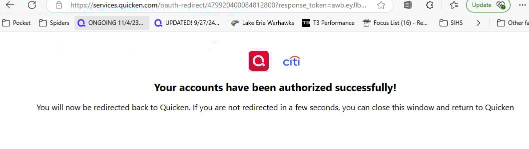

I am still having same issue as others have reported trying to setup/reauthorize my Citibank Shell Mastercard for online access.
First I select the Financial Institution in Quicken
Quicken says I need to authorize with Citi
Browser opens on a Citibank page. I am able to login with my credentials.
Citibank site seems to be having some sort of issue and is unable to display the account name (i.e. Shell Credit Card" or "Shell Master Card" or something other than "null"). The page is also not properly displaying what info will/won't be shared.
Nonetheless, filling out the page and selecting "Authorize" redirects to a Quicken hosted page (see URL) and returns a successful message.
But when I return to Quicken - the Quicken app sadly tells me that the sign-in has failed.
I have reported this issue to Quicken through the app.
At this point I'm not sure if this is an issue on the Citi side or on the Quicken side…but either way I have been unable to setup my account for transaction download.
