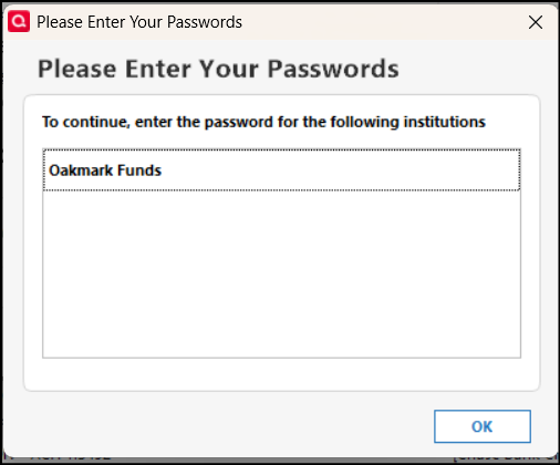

Oakmark Funds & Janus Transaction Download - Issues with Password [Edited]
I just wanted to add my voice to others. I too am running version R65.17 Quicken Classic and am facing the same problem expressed by other re: the Oakmark password problem. To Quicken support - please get on this ASAP and year transactions are many. My thanks to others for the suggestion to roll back to R64.30.

Having same issue with Oakmark download. When I attempt to download from the Oakmark menu I am asked to input the Oakmark password. When I add the password, I get the below message. I am using Quicken Classic release 65.17 build 27.1.65.17 with the data file on my local machine.

I'm not able to add an Oakmark password in the password vault or in updating Oakmark directly from the Oakmark "Update Transactions" button in any release later than release R64.30. Release R64.30 allows me to add an Oakmark password, although it warns that Oakmark requires no more than eight characters (Oakmark requires between 10 and 20 characters). Any later release will not take the Oakmark password. If I try to add the password, I receive a request to enter the Oakmark password, even though I have just entered it. Is anything being done to resolve this issue? this has been an issue for weeks now. It's the end of the financial year, and accurate financial information is critical at this time of year.

Neither Q, nor you, can fix this. Oakmark has provided incorrect info ("max 8 characters") to Intuit and Oakmark needs to correct the info that Q/Intuit has.
