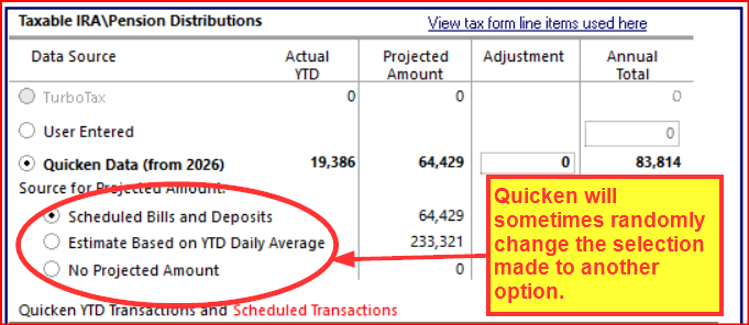

    I've noticed that sometimes Tax Planner (TP) sometimes randomly changes the option I selected to one of the other options. That, can cause some significant errors in TP's projections. It does not happen a lot but every few days I will find that the TP projection of tax refund or tax owed was changed from the last Quicken session. That prompts me to review every section of TP and it's always been found that this issue occurred in just 1 or 2 sections. I fix those and everything if fine, again, for a few days and then the same thing happens in a different 1 or 2 sections. So, yeah, there does seem to be some reliability/instability issues with the 2026 TP.
    Other than this it seems to me that TP is functioning normally.
    I should also state that for the first 1-2 months of just about every year I usually experience at least one TP stability/reliability issue. I usually just ride it out for the 1st couple of months and then everything seems to be self-resolved.

    I am also seeing changed settings in the Tax Planner as described by @Boatnmaniac above. After entering month-end dividends, several of my settings were changed from "Scheduled bills and Deposits" to one of the other settings.
    I run the Tax Planner periodically to look for any significant changes in the tax or refund due. When there is a change, I must go through all the settings and correct whatever has changed. Very annoying!
    I have not installed any updates since I carefully set up these settings a couple of weeks ago, but I did open a backup file and then returned to my current working file.
    After correcting the settings, I ran a Validate and Repair and it did did not find any problems or affect the Planner settings.
