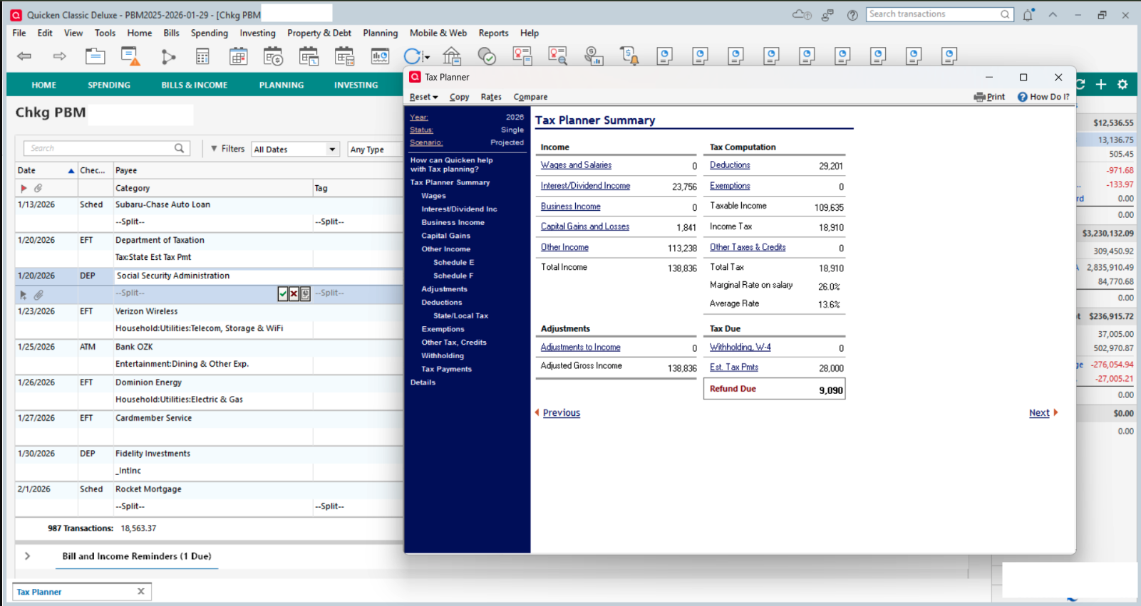

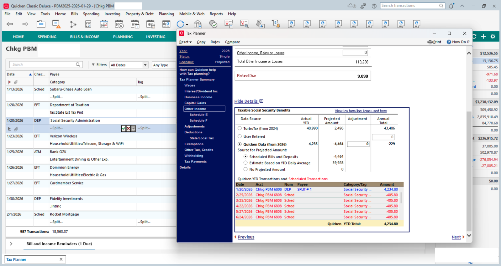

  • petermartin1950
    petermartin1950 Quicken Windows Subscription Member ✭✭
    edited 10:23AM

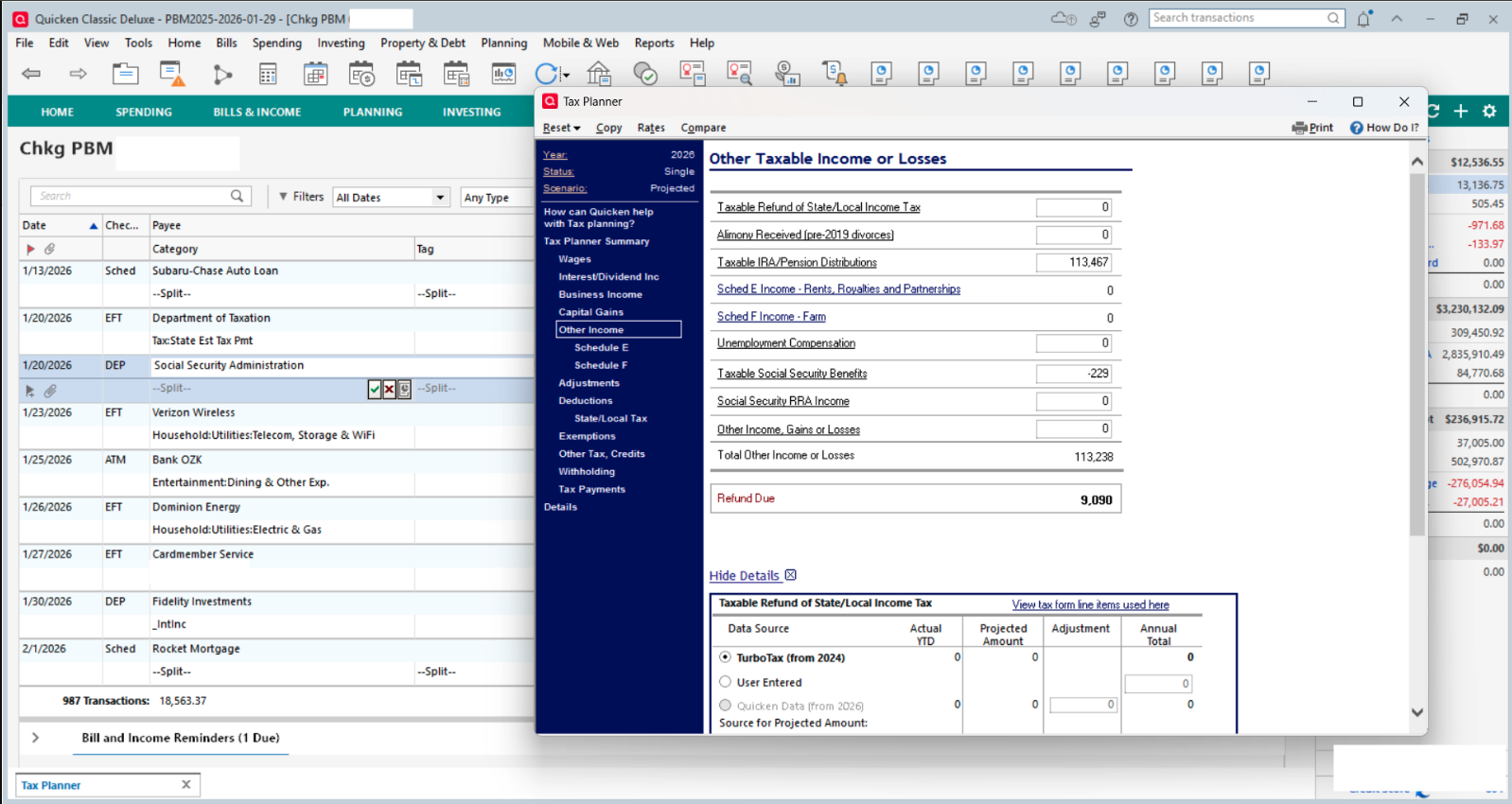

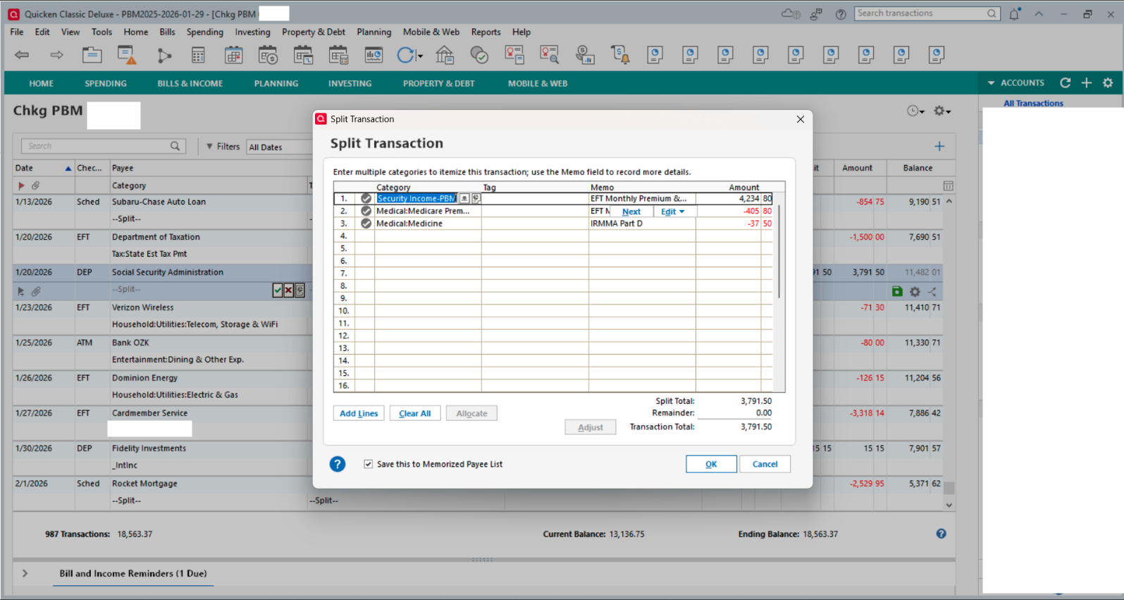

    January SS entry to checking account using a scheduled transaction

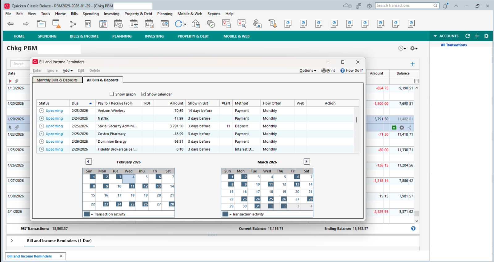

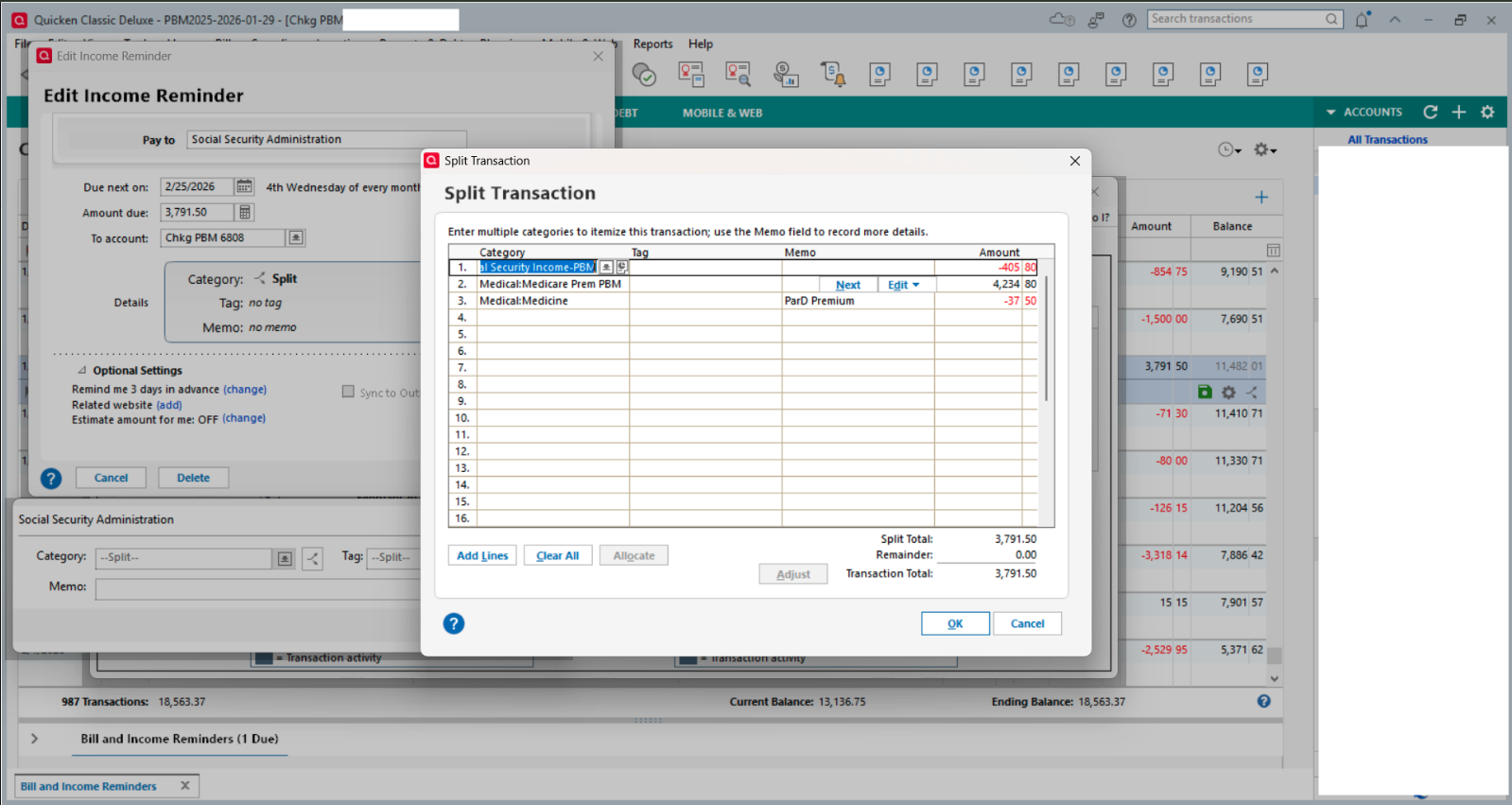

    February scheduled transaction for SS income for 2/25/2026
    Details of split for 2/26/2026 Deposit incorrectly jumbled split from the scheduled transaction
    Tax Planner (TP) showing incorrect Other Income of $113,238

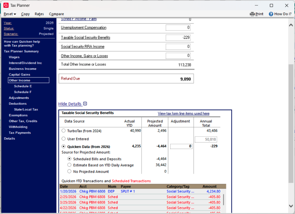

    Detail of incorrect Other Income Taxable SS Income of -$220
    Incorrect detail of 2026 remaining scheduled transactions, as well as missing all other scheduled transaction splits
    Can anyone help get this issue with Quicken remedied?

  • Boatnmaniac
    Answer ✓
    Regarding the SS split category issue: Sometimes a Reminder can get corrupted and there really is not fix when that happens other than to try doing the following:
    1. Try editing the splits to get them set up correctly, again. This will often resolve such issues.
    2. If #1 doesn't resolve it: Try deleting the Reminder (the entire series) and then set up a new Reminder to replace it.
    I had a similar issue with my SS Reminder splits starting with January, as well….a little different in that it replaced the gross SS benefit amount with the net deposit amount and then removed the splits for the various deductions. This happened in 3 out of 4 SS income Reminders in 3 different data files. I tried to fix the splits but they could not be fixed. So, I ended up deleting the bad Reminders and setting up new ones to replace them. So far, it looks like they are OK and stable now.
    If one of these 2 things fixes the category splits issue, it should also fix the Tax Planner issues.
  • petermartin1950

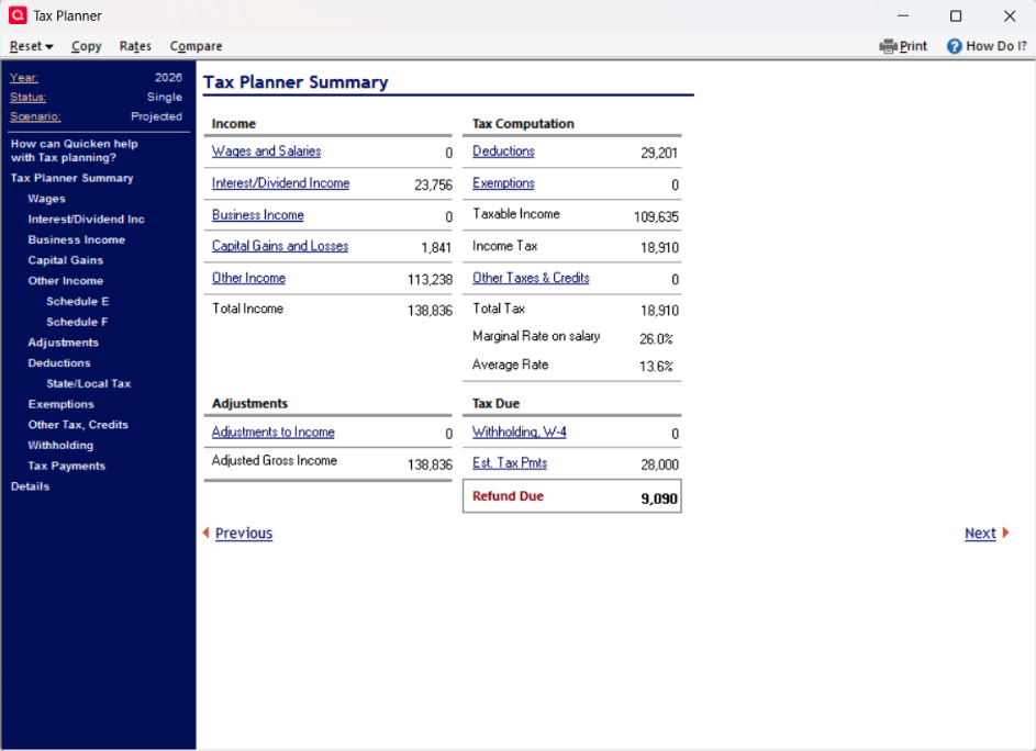

    edited 10:24AM
    TP Summary showing incorrect information based on scheduled transactions which splits have been jumbled. This is as of Feb 2026. And the Feb SS Income has not yet been processed.
    [Edited - Removed Personal Information]
