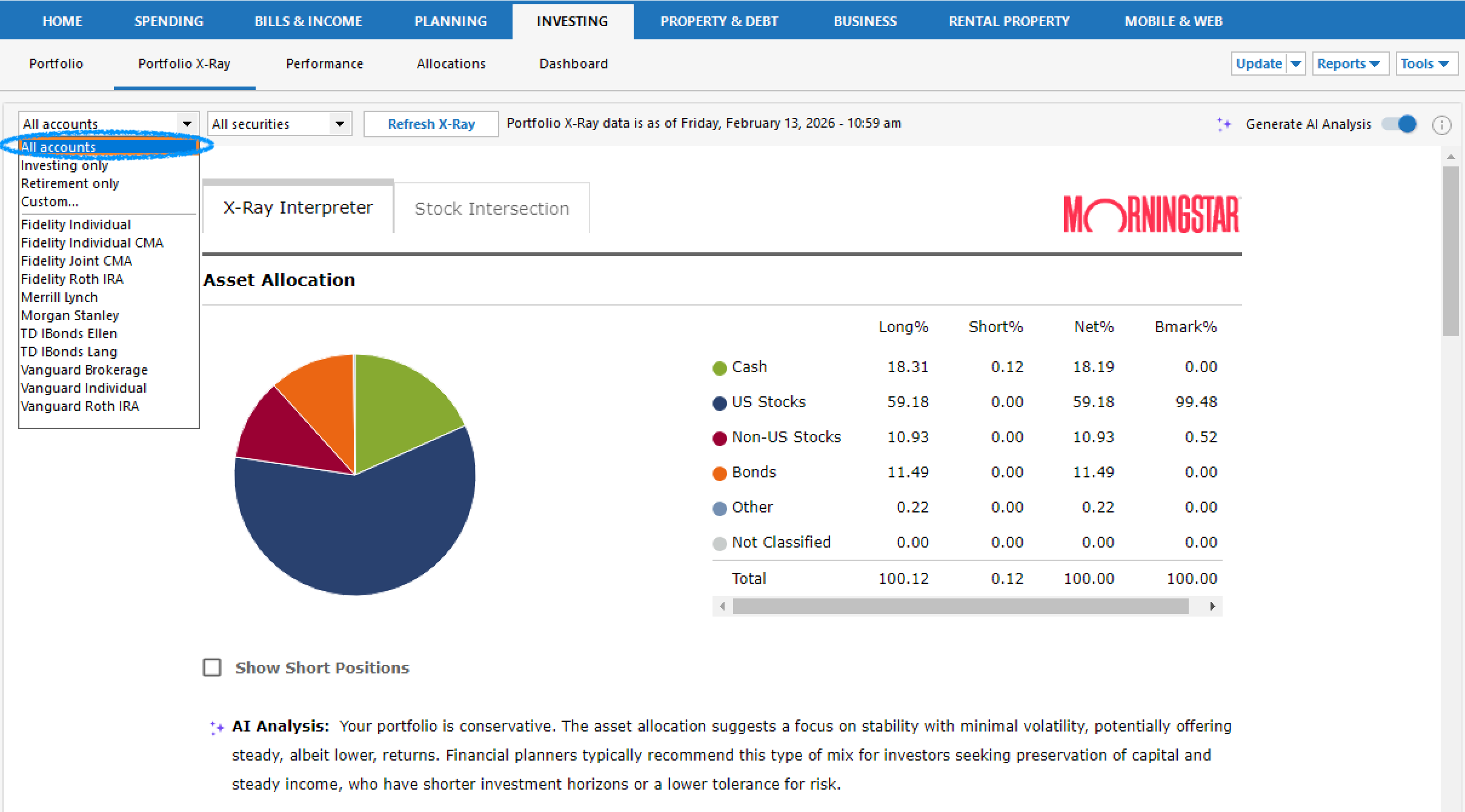

Quicken not only fixed the Portfolio X-Ray ETF issue, but it's going to be better than ever with the AI Analysis feature (which seems to think my 70/30 stock/bond allocation is conservative. I'm sure it's not seeing the allocation that is now correctly shown).
You have to refresh X-Ray to enable the update. I do this by re-selecting "all accounts" instead of the obvious "Refresh X-Ray" button. In the past, this worked better - maybe now that's been fixed as well. TBD.
