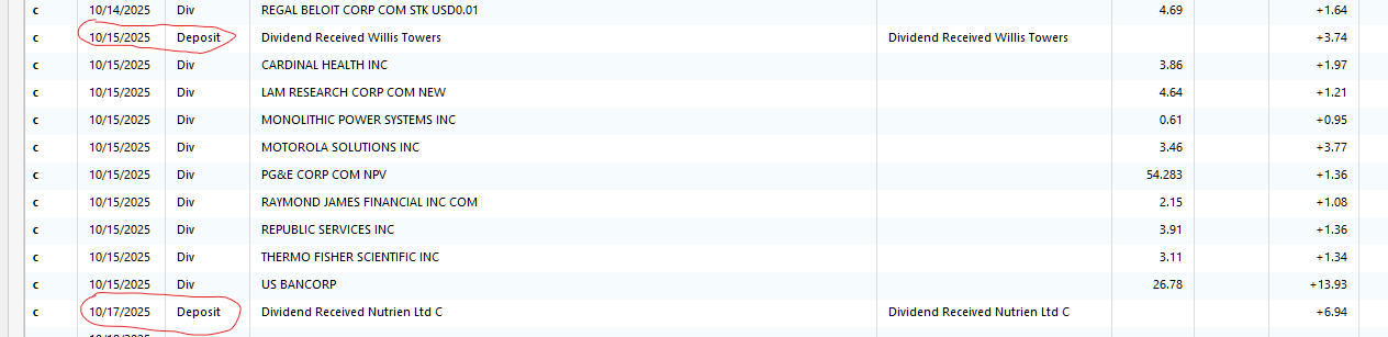

Perhaps this is one of the post about Dividends?
https://community.quicken.com/discussion/comment/20514895#Comment_20514895

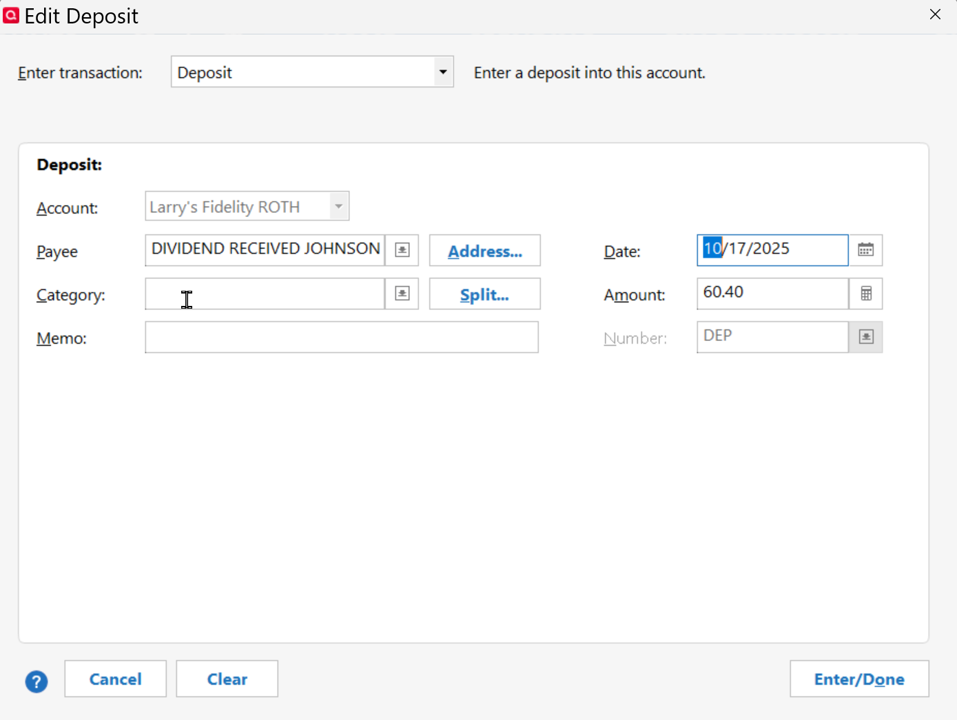

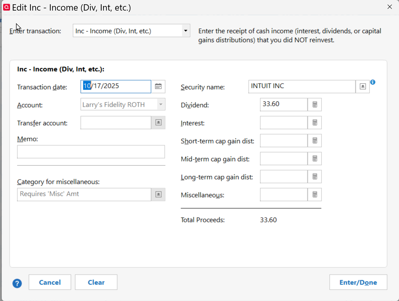

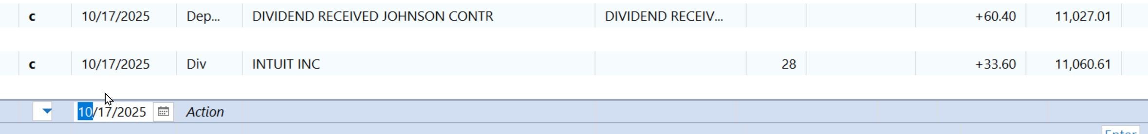

Another example of incorrect Dividend transaction posting as a Deposit without a category assigned.
In screenshot, two transactions, one (Intuit) processed correctly, the other (Johnson Controls) processed as deposit instead of Dividend.
I believe Johnson Controls (JCI) is an international stock.
Register Screen shot
Edit of incorrect Deposit screenshot
Edit of Correct Dividend screenshot
I will manually correct the Johnson Controls entry to reflect Dividend and Category _DivInt

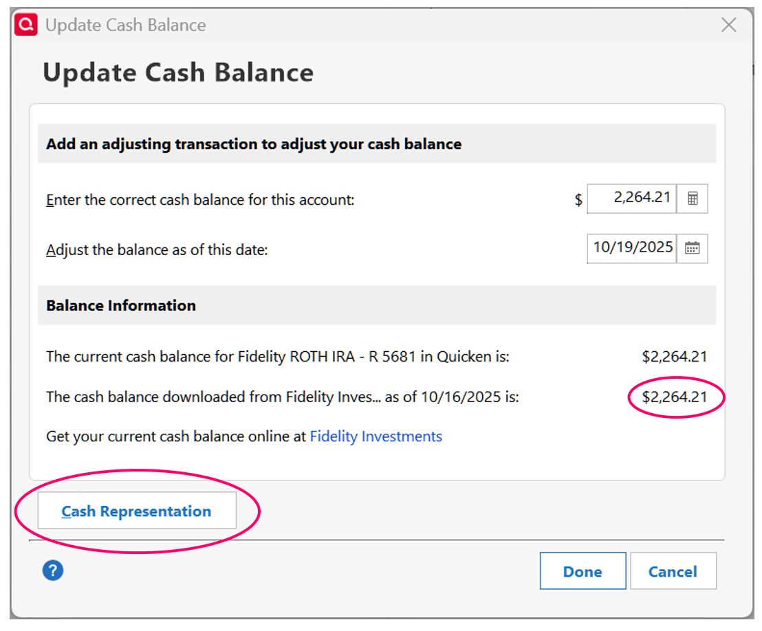

Below is a screenshot of the "Update Cash Balance" pop up from Fidelity in my test data file. It always used EWC+.
In both working data files, both before with DC and after updating the connection to EWC+, the "Cash Representation" button is missing in Fidelity and the cash balance from the website is zero. The button is needed to select the correct sweep fund used for cash. Fidelity uses FDRXX and Schwab uses SWGXX.
Interestingly, the button is also missing in Schwab but the cash balance from the website is correct. During the conversion, Fidelity creates a CASH account using a symbol of FCASH. It doesn't appear it is ever used.

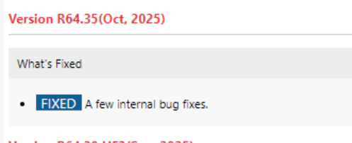

Had a Quicken Software Updated today.
I guess the few internal bug fixes were NOT associated with the Fidelity EWC+ issues.
