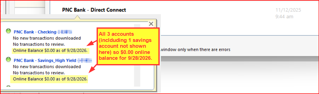

    Maybe I am missing something, but I have yet to see anyone post that as of this afternoon their downloads started working and their balances are correct. What I have seen posted are from folks that either had working PNC Direct Connect prior to today, got EWC+ instead of Direct Connect today after Disco-Reco or have had intermittant success for the last week. I hope I am wrong.
    My accounts are not working for downloads, balances (still zero) or sending new payments. I'll try reconnecting again later today.

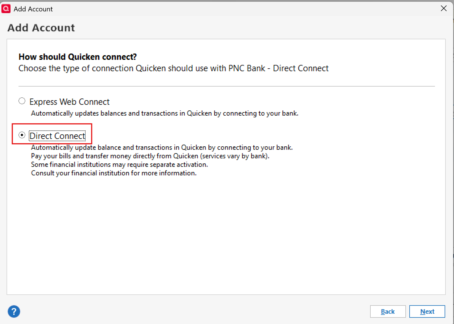

  • Boatnmaniac
    Make sure you are doing Add Account and not Set Up Now. Then select PNC Bank - Direct Connect and make sure to click on Advanced Options. I have found that this FI link is defaulting to EWC+ when it should be defaulting to DC. Clicking on Advanced Options will provide you the opportunity to select DC so it will not set up with EWC+.
    FYI: For me, after selecting DC the set up process has been failing and I am prompted to enter my SSN and a new PW. If you get this prompt DO NOT DO IT. Instead, cancel the process. If you don't it might take PNC Tier 3 to reset your account at PNC in their system so that you will be able to at some point in time download with DC, again.

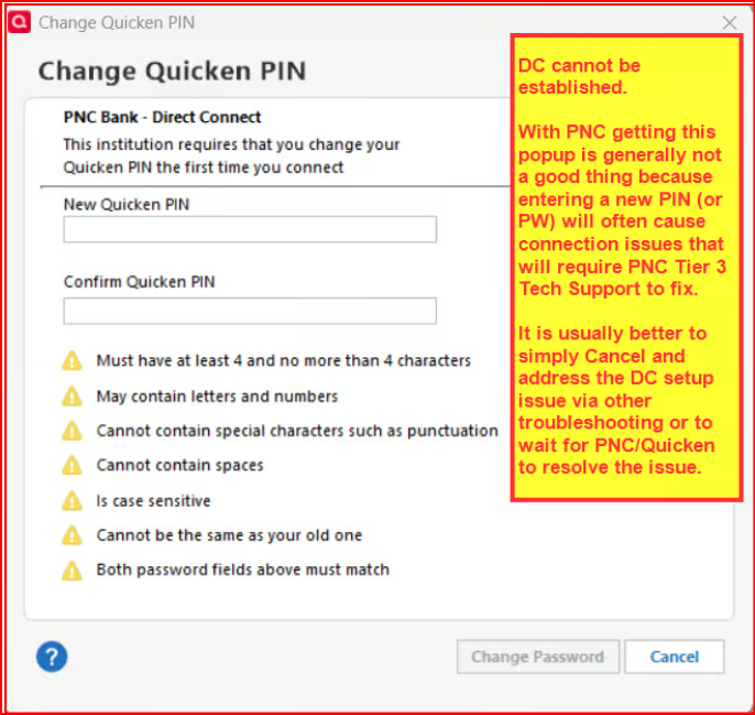

    November 11 - Quicken Direct Connect still not working for me. I get the following message: "Did you mistype your sign-in info? Please re-enter your credentials for PNC Bank - Direct Connect."
    It asks for my SSN and PIN - I enter that information. It then says that PNC requires that I change my PIN. I then change my PIN and get the message about mistyping my sign-in info. I don't get it!!!

    New set up of PNC Bank - Direct Connect in Add Account in a test file continues to fail and produce the following prompt which I will decline to complete because of the significant issues it causes with PNCs system requiring a Tier 3 PNC person to reset something in their system. (This is a different issue that has existed with PNC Bank - Direct Connect for years.)

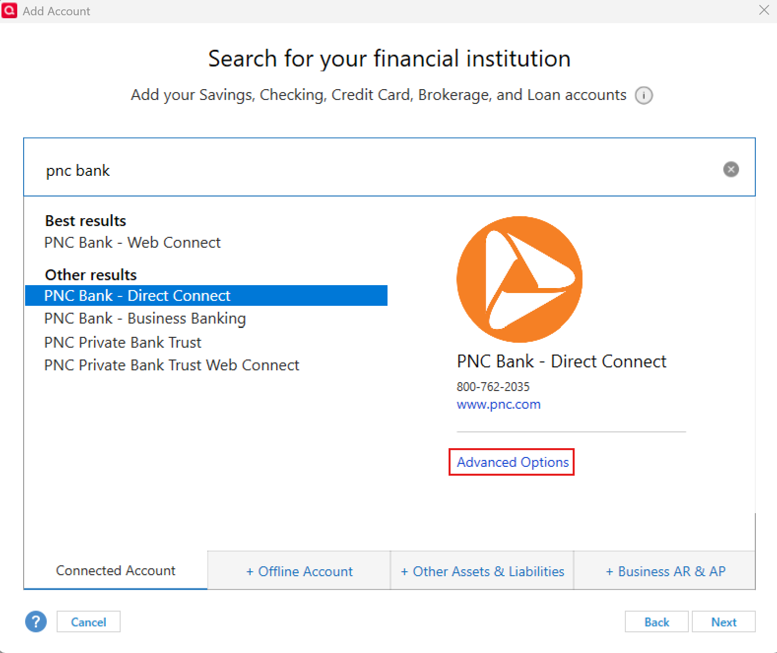

  • Quicken Anja
    Quicken Anja Moderator mod
    Hello again,
    Thanks for keeping us updated!
    When deactivating and reactivating your PNC Bank – Direct Connect accounts, please be sure to select Advanced Options > Direct Connect during reactivation.
    If the accounts still fail to reconnect after doing so, we recommend contacting Quicken Support directly so our team can gather the necessary details for escalation.

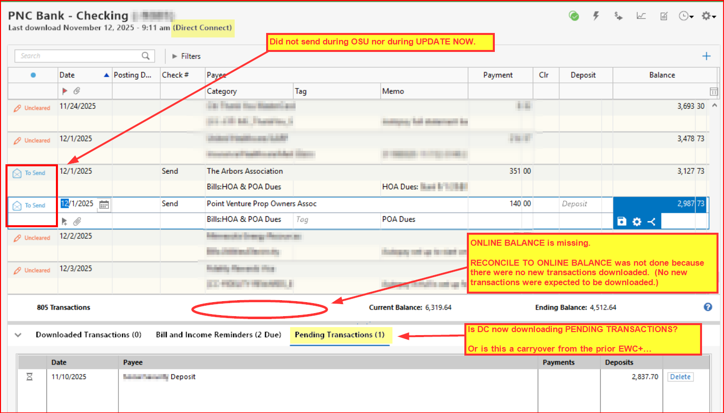

    In a test file I got excited because I was finally able to set up a DC connection and a lot of new transactions were downloaded.
    So, I then deactivated my EWC+ connections for my PNC accounts in my main data file and did Add Account>Advanced Options>Direct Connect>Linked the downloaded data to the correct accounts already in Quicken. The accounts are now shown in Quicken as being connected with DC! But that's where the joy ended:
    1. ONLINE BALANCE (on the left side of the OSU Summary below "PNC Bank - Direct Connect): Shows $0.00 as of 9/23/2026! image.png
    2. ONLINE BALANCE (below the Account Registers): Still not present. Note: I did not try to do Reconcile to Online Balance because there were no new transactions downloaded. I will try doing this either tonight or tomorrow after a new posted transaction is supposed to be downloaded.
    3. DC BANK BILL PAY: I set up two payments and ran Update Now (this is after DC had already been connected). The payments did not send and still shows in the register as "To Send". (I confirmed that Bank Bill Pay is enabled on the Online Services tab of Account Details.)
    4. PENDING TRANSACTIONS (below the Account Register): Shows a pending transaction that will likely post later today and be ready for downloading tonight or tomorrow morning. Note: I believe this was downloaded with EWC+ before I had changed the connection to DC. So, maybe it just did not get removed by the DC connection set up? image.png
    5. ROUTING NUMBERS: I noticed an oddity. When the accounts were set up with EWC+ the Routing number on the General tab of Account Details was 7138 which I could find no reference to in my online PNC account. But with DC it is 071921891 which is the routing number referenced in my online PNC account. Why two different routing numbers, one of which (for EWC+) does not show up on the PNC Bank website? I don't know but what I do know is that PNC has a different routing number for each state. Maybe EWC+ is routed through a different state than my accounts are actually set up with?
    At any rate, DC is not fixed (at least not for me) regardless of what Quicken and PNC have communicated.
    (EDIT: I did submit a report referencing this post via Report a Problem.)
