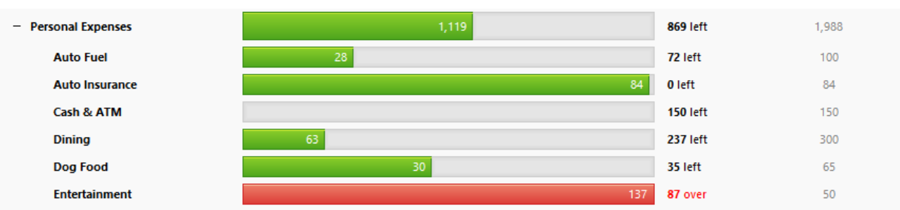

    There were green or red bars for each item tracking that showed the progress of budget spent items. Thank you in advance for investigating this problem.

    Attached is pre-R65.17 update.

    Before the recent 11/25/2025 update a green or red bar would indicate the amount spent on each budget item. How do I correct this setting or ii it a problem with the update? The picture is from BEFORE the update. Picture below is AFER the update.

    Discovered a quick fix….Go to Planning Tab and then go back home and the bars are back!!!

    Thank you for your suggestion but that was the first thing I attempted and it did not correct the problem. The bars do appear in the Planning section but returning to Home they are gone.

    Actually, I'm experiencing the same result in the Home tab, and this does appear to be an issue with 65.17. Navigating to the Planning tab then back to Home doesn't resolve the issue for me.

    Going to planning and back worked for a while but even that doesn't seem to work today.

    I'm having the same problem. I found that selecting the categories to watch option in the Main display on my Home screen, and then checking or unchecking a category and clicking OK seemed to bring the bars back, at least once. However, they disappeared when I navigated away from the Home tab and then back. Now I can't them back using the workaround above.
    This is clearly a bug introduced in the latest upgrade (~11/25/2025).

    I am having the same problem, this is a bug. I was hoping it would have been fixed by now. My quick fix is going to the planning tab like RichardSchreyer suggested, back to the dashboard, then switching to another budget and then back to your current one under the settings gear → show budget. Make sure the budget that you switch to has budget categories to show. I hope this helps until the bug is fixed.

    I can confirm the workaround. I can restore the bar graph contents by pulling down the graph settings menu (gear icon) > Click on Go to full budget > Go back to the Home tab > Click on the graph settings gear icon > Click Select budget categories to watch… > Select OK.
    At this point, the bars are restored on my system. However, after exiting the current session and starting a new session, I have to perform these steps again.
